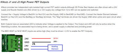

Just plugged in my KNozzle to test it out. As soon as I run "KNozzControlTemptsMCode.c" the watchdog signal kicks on, and the heater turns on. Checking the console, it says the nozzle and bed setpoints are 0C, and I dont have any thermistor hooked up. Does this seem right? The documentation is slightly confusing about where the power goes. Is my image here correct?

I don't see any image.

I tried to add a picture a number of times last week, but it wouldnt attach. It shows in the bottom, but when I click the "preview" button the attachment is removed. I tried a JPG, TIF, and PNG file format.
No I didnt use an M-Code, the P and Q parameters are both Zero. That was why I was surprised that the coil started to heat.
Scott

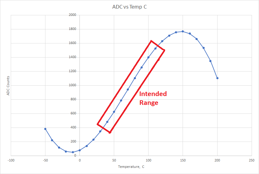

The default KNozzControlTemptsMCode.c code assumes a Thermister 3rd order function of:

Here is a plot of the Function. This polynomial was intended to be used over the range shown here
A setpoint of 0C corresponds to an ADC reading of 41 counts. Without any Thermistor (infinite resistance) an ADC reading of 0 counts would be "cold" and therefore activate the heater.
It would probably make sense to add a test for a nonsensical ADC reading (ie < 100 counts) and disable the heater.

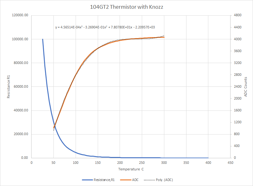

The 3D printer I am making needs to be able to handle temperatures close to 300 (475 F) degrees C. So I will need to use a different function to convert temp to ADC. Here is the one I am trying to use(part number 104GT-2) sold on Amazon, rated to 300 degrees C.
https://www.mouser.com/datasheet/2/362/ ... 202937.pdf

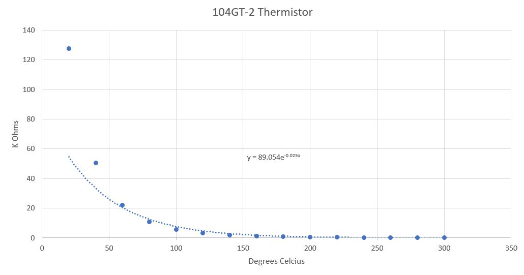

My plan was to plot the profile, and make an equation for the function. Here it is:
This is my first time trying to profile a thermistor and I am not certain I did it right. If I did, my concern is how flat the curve is at the upper range of temperature. At a fraction of a KOhm the temperature jumps a lot. Do you think this would make for stable control?
If you think it will work, my next step is to convert KOhms into ADC counts, and put the equation into the function?
Scott
Thermistor Values.xlsx
(22.96 KiB) Downloaded 206 times

Amit tried to use the same sensor some time ago and had poor resolution at higher temperatures. There was a discussion on cnczone here.
In the Thread there is an Excel sheet to calculate KNozz ADC counts vs Temperature the result is copied below.
The sensor resistance becomes too low when used with the 10K ohm resistor built into KNozz. A better solution is to pick a sensor with a higher resistance such as the 105GT2. Or add a 1K resistor to the KNozz Terminals to reduce it's resistance.
