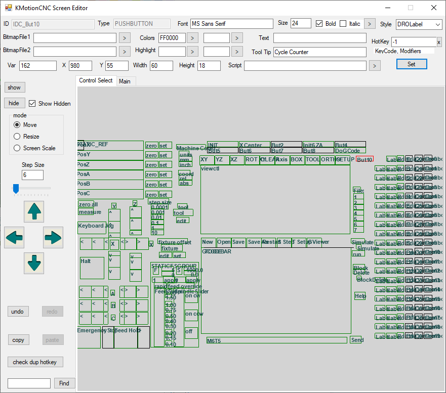

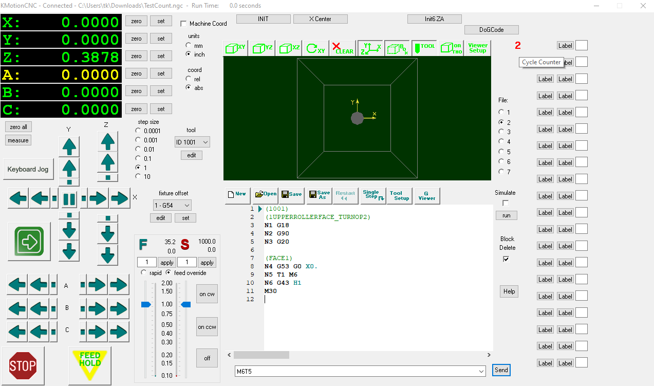

You might add a DROLabel to your screen such as shown here in red.
Configure it to monitor Var 162 for a string to display as shown here:

Then call the Count Program when you want it to increment. For example you might have M30 (end of Job do a count)
You might also add a User Button that executes the ClearCount.c Program to Clear the counter
