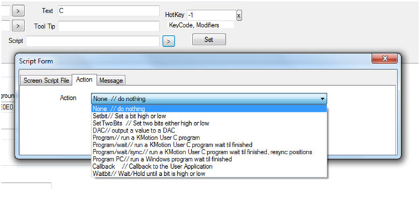

  • Script
    Using this field, the user has three options shown below.
Video demonstration of the creation of Screen Script to perform Windows Messages
Control Script Options
a) Selecting a screen script file from the library:
b) Selecting an Action:
c) Selecting a Windows Message:
