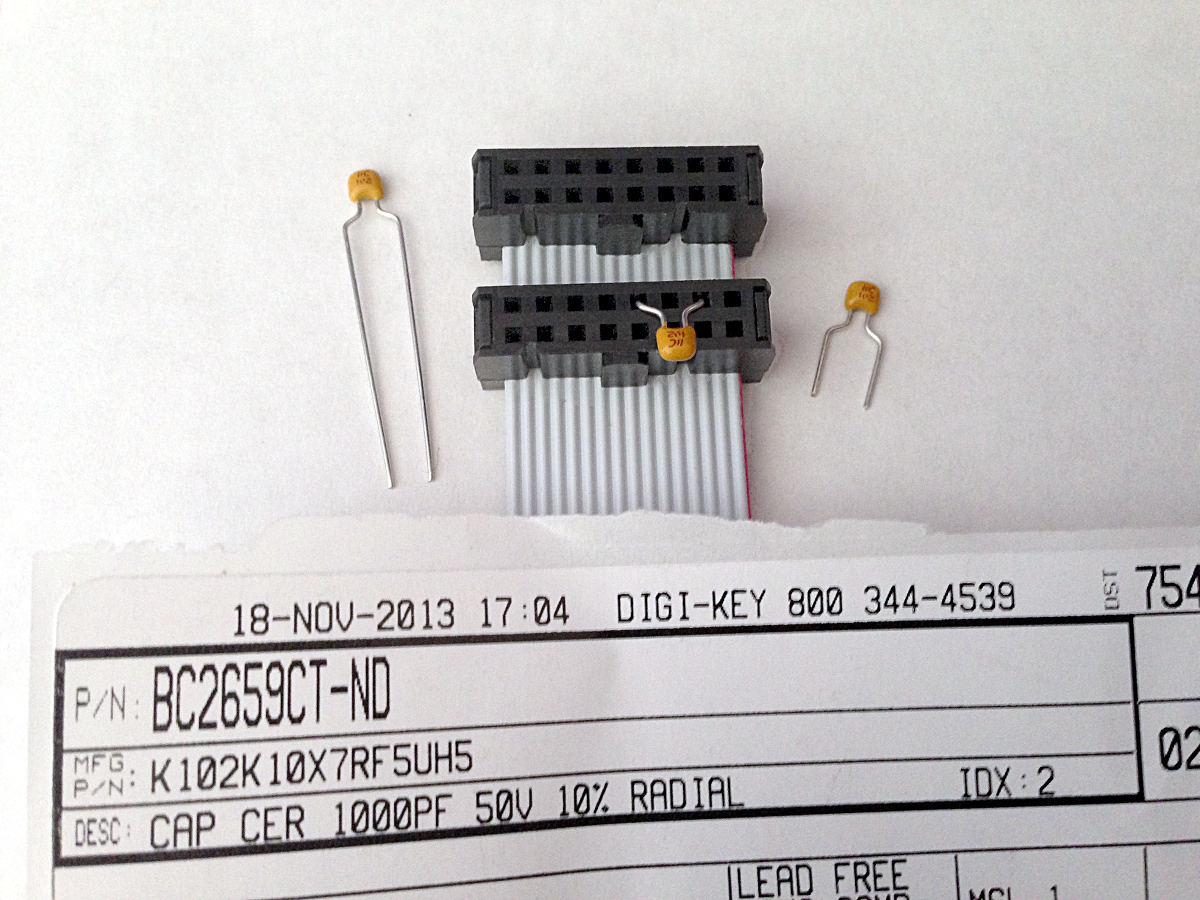

As a test you might add the capacitor very close to KFLOP with an approach like this.
That would confirm noise on the inputs.The limits are configured "Disallow drive into limit".

I'll also try and add the capacitors as you suggested, just have to solder 3 pins together in order to use the 2 GND pin openings for the 6 switches.
Is 1 nF enough?
Is 1 nF enough?

1 nF is normally sufficient unless the noise pulses are exceptionally wide and large. Since the limits aren't relatively fast a larger value such as 100nF might be used. Although bigger isn't always better. Do you have an oscilloscope? Here is a good article.I'll also try and add the capacitors as you suggested, just have to solder 3 pins together in order to use the 2 GND pin openings for the 6 switches.
Is 1 nF enough?
