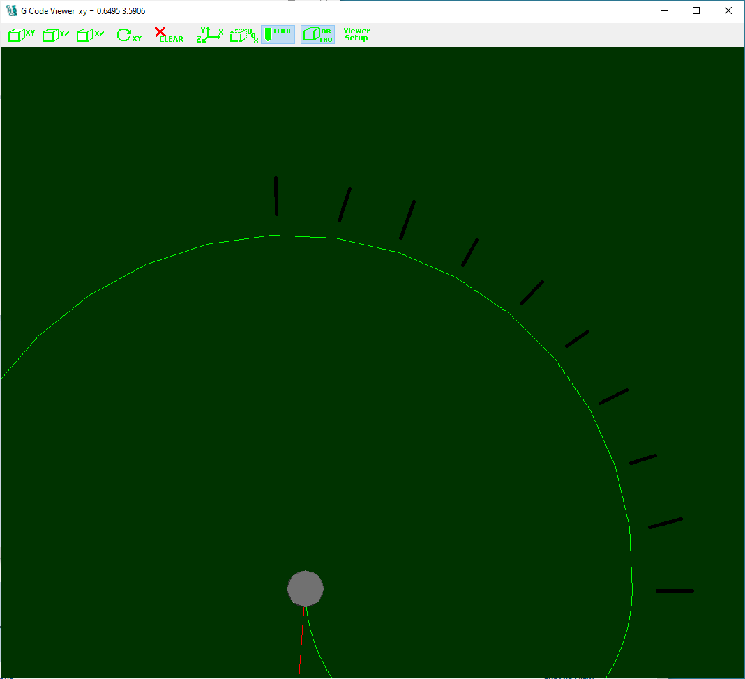

I am currently developing a fairly fast machine and while testing some path generated by our software for Trochoidal milling (fast feed discrete arcs), I experienced a lot noise and jerky motion. I made a long test session and I report only the relevant results I found.
I use the latest 4.35f version (but since 4.35b the issue is the same).
I also disabled any smoothing via KLP to make things clearer.

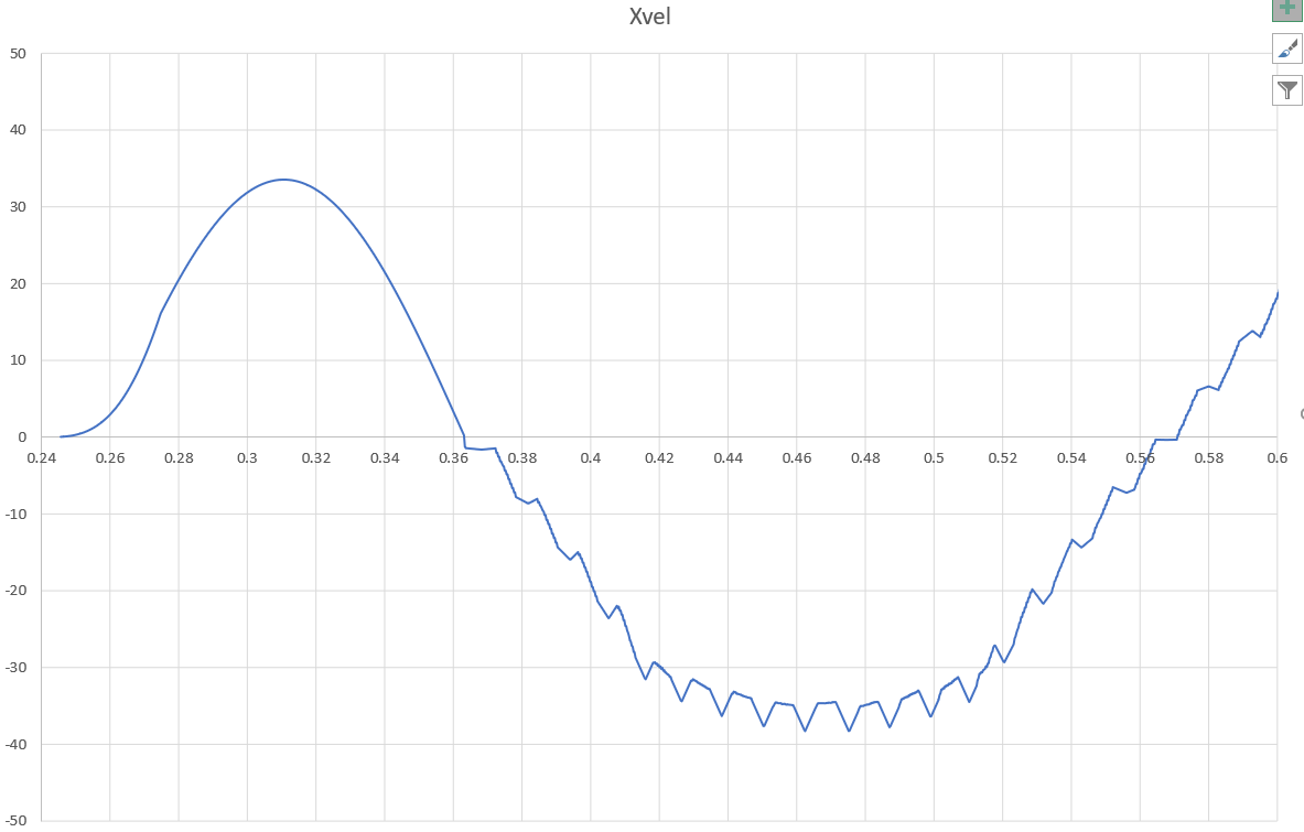

I created a small test program with a simple half circle (via G3) and the a small spiral arc made with discrete segments. the segments where created by our SW according to a maximum cordal deviation from theoretical curve of 0.01mm.
When I execute the code the machine behaves differently when perfoming the arc (very smooth) and the discrete curve (very jerky).
as parameter of the TP I use: Break Angle 30.0, facet angle 0.5/1.0 (small differences), Corner tolerance 0.01mm, collinear 0.0, arcstosegs=false.
I went deeply into trajectory analysis and it seems to me perfectly tessellated: TP creates small arcs between segments consuming all the half segments (that is what i expect because we discretized with 0.01 chordal error and TP has the same tolerance for rounding): the result is a fairly rounded spiral arc. The issue is the velocity commanded along the spiral: with those parameters is strangely different from the similar arc in G3.
Even more strange if I modify CT to 0.005mm. The trajectoy still appears good (this time it consumes about 1/4 of each segment in rounding each corner) but the velocity has jumps that makes the motion a mess.
Consider Gcode has a feed of 5700mm/min and the max velocity is 200mm/s (12000mm/min) with max acceloeration of 1000mm/s2 for alla axes.
Please see velocity plots attached relative to X axis velocity with CT 0.005 and 0.01 mm; Velocity is axes "last_vel" field.
I also attach Gcode that generated the plots (M102 and M103 are acquisition start/stop programs)
Looking at the plots is quite evident the difference between the first G3 part and the subsequent discrete curve.
It is quite evident that the TP is doing perfectly well with geometry, but it seems to mess something with Feedrates of created segments.
Do I make something wrong?

Well, I have some updates.
Analyzing the trajectory in both cases and looking how the feedrate is adjusted along the segments the behaviour makes more sense to me:
- the first case (CT 0.01) is reasonable because the requested fedd of 95 mm/s is too much for the curvature of the spiral arc. it is limited by the maximum acceleration according to the curvature formula sqrt(A*R). some minor spikes maybe due to smaller segments and some numeric errors. To bear in mind that this is a special case because CT is exactly the same of the max error used generating the spiral discrete segments: this is not always possible to match.
- the second case (CT 0.005) is more interesting: the treajectory is a sequence of straight segments and rounding curves (this because reducing CT the planner consumes less than the whole segment in rounding). At this ponit we have the straight segment at required feed (95mm/s) and the rounding curve limited by the maximum acceleration (about 48mm/s). The result, as visible from the plots is continuous acceleration and brake along path at a rate of the number of segments in the original curve. That is the reason of the terrible sound executing this path.
Is there a combination of params to avoid this effect? The first thing that comes in mind is a sort of "second pass smoothing" on the feedrates...
Another strange thing is that in the first case I should not have those vibrations at all with no sudden velocity variation along path, but if I go further with the spiral path (meaning increasing the radius) the vibration increases a lot. I can't understand why, because, in that case the curve should be always a continuous curve even at larger diameters.
I'll make a path acquisition at larger diameters to see what's going on and report back the results.

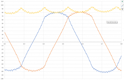

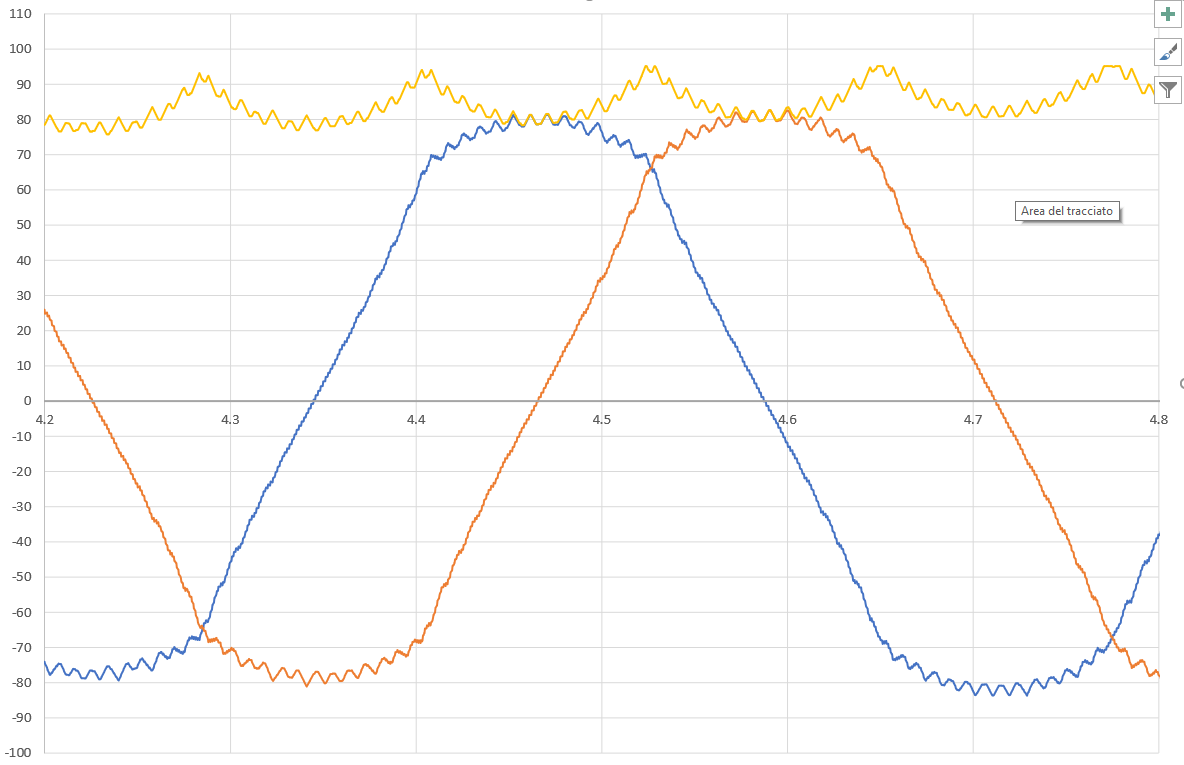

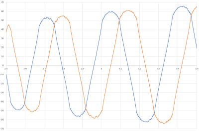

Another update.
I made further testing con the CT0.01 case because the sound was better than the other cases but something was wrong to my ears.

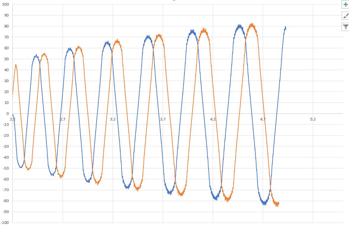

I acquired a larger number of samples while spiral goes on towards a diameter large enough not to be limited by acceleration.
As you can remember the first round at small radius exhibits some noise, but reasonable continuous velocity.
the result get worse increasing the radius.
Please see attached plots.

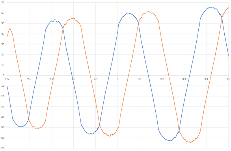

The first one shows the velocity of X and Y axes up to the radius that limits the velocity according to acceleration.
The second is a detail view with the velocity modulus added.
You can easily see the velocity jagging and the modulus as well.
Looking at the modulus we see a lower frequency oscilation, but I suppose it is due to the choice of limiting each axis with its own acceleration, thus meaning that in combined motion actual speed can overcome the single axis speed limit.
My suspect is that the generated geometry, even if as trajectory is good, has some discontinuitities in curvature. I do not exactly understand why, but seems that some segments are smaller and with different curvature than the adjacent one, so limits are applied with noticeable difference to those segments increasing locally the velocity and suddenly decreasing in the next segment bunch (where curvature is restored).
Is there a simple way to plot the exact points with associated feed velocity generated by TP?
I think it should help very much in understanding this behaviour.
Thank you very much
Best regards
Giancarlo
Its not clear what you are expecting. I count 9 line segments for a 90 degree curve. So there is a line segment and a 10 degree corner repeating. The trajectory planner is accelerating during the line segments then decellerating for the corners. If you force the TP to follow that path exactly it has no freedom to smooth things.
Can you create GCode with shorter segments and smaller angles? Basically smoother?
Correct. The combined velocity is lower where an axis is not moving.
Sorry I don't understand what you mean.

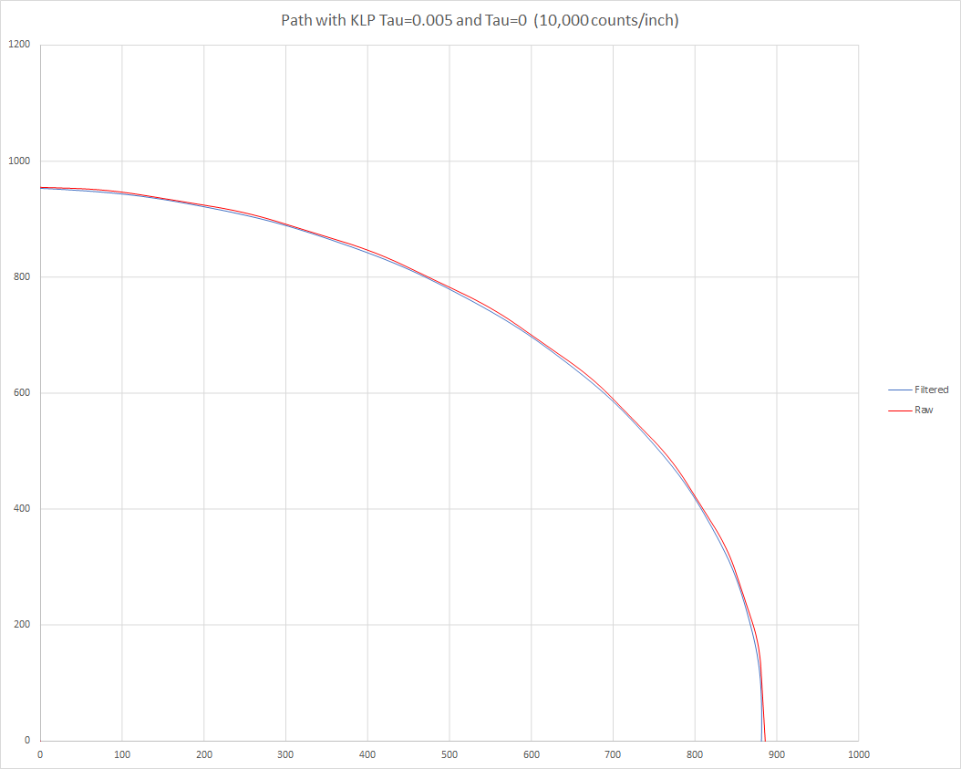

I did add a LPF Tau = 0.005 seconds and it did some smoothing and the path only seems to deviate from the original by ~ 0.01mm
Sure this is a possible way, but further smoothing motion will not remove the problem. The path is already smooth (see plot), the velocity will be smoothed slightly (meaning the problem is attenuated but not solved). Anyway increasing too much KLP adds error that sums up to TP smoothing... 0.01 (from TP) + 0.0125 (from KLP) means more than 0.04 on hole diameter... just from geometry (you have to add path following error); maybe acceptable in some context less in others.

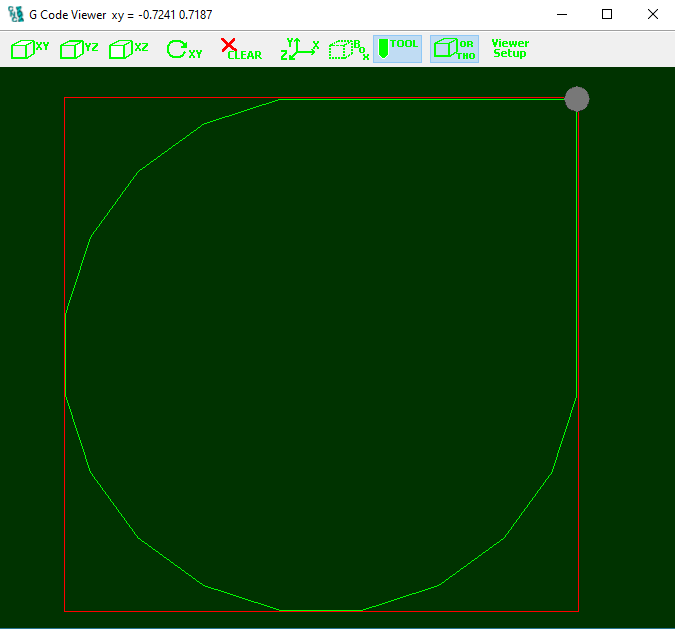

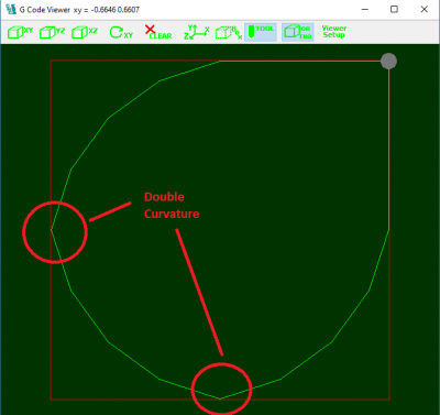

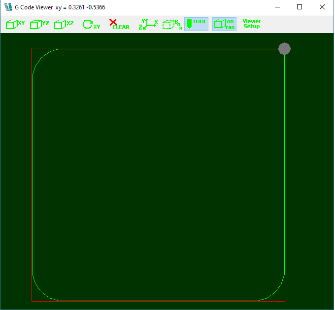

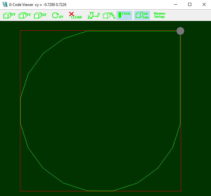

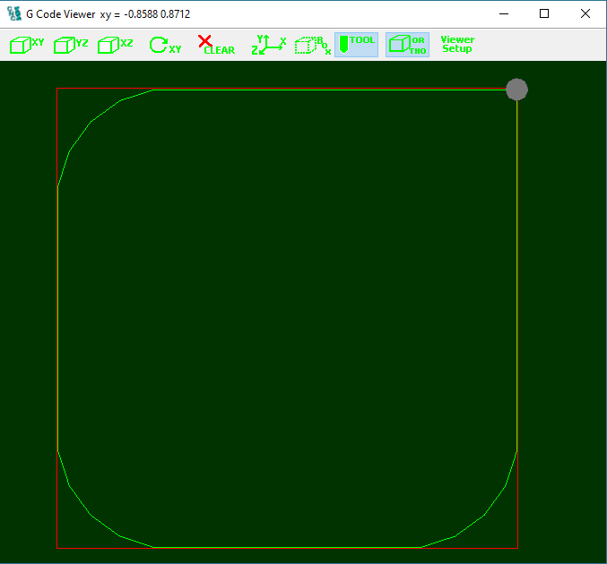

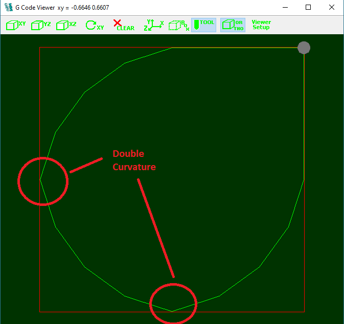

I think we found a significant issue. When two adjacent corners are "rounded" and both use the entire segment this results in a pair of segments with double "curvature".
Here is an exaggerated test case 2 inch square with 90 degree corners rounded with 22 degree facet angles for visualization.
CT = 0.1 inches
CT = 0.2 inches
CT = 0.3 inces
CT = 0.4 inches Entire segment consumed
Ct 0.5 inches
Previous Versions would result in this where a point of double curvature would occur causing a deceleration and slowdown.
The new version leaves 1/2 of a segment facet of the original segment so when combined with the next corner results in a more consistent curvature.
Please let us know if this shows an improvement in your system
Here is a patch for Version 4.35f. Replace this GCodeInterpreter.dll in the KMotion435f\KMotion\Release folder

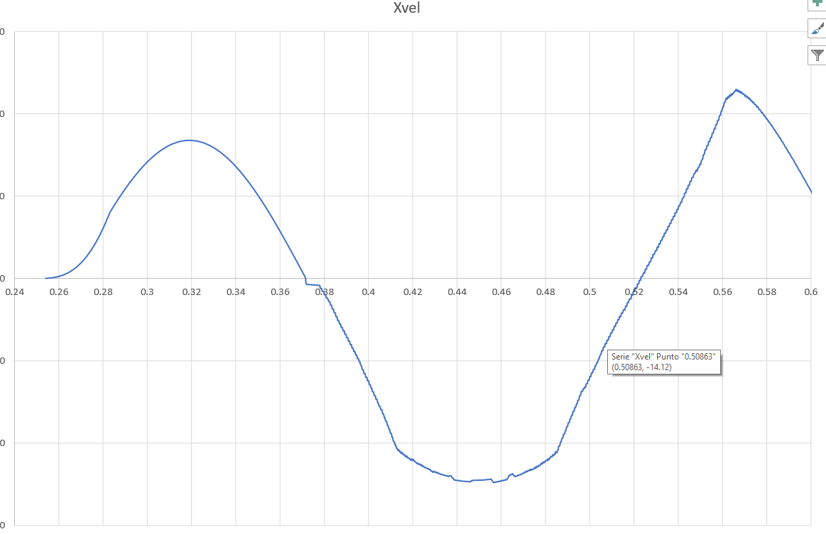

Post by gnrules » Tue Mar 09, 2021 6:10 pm

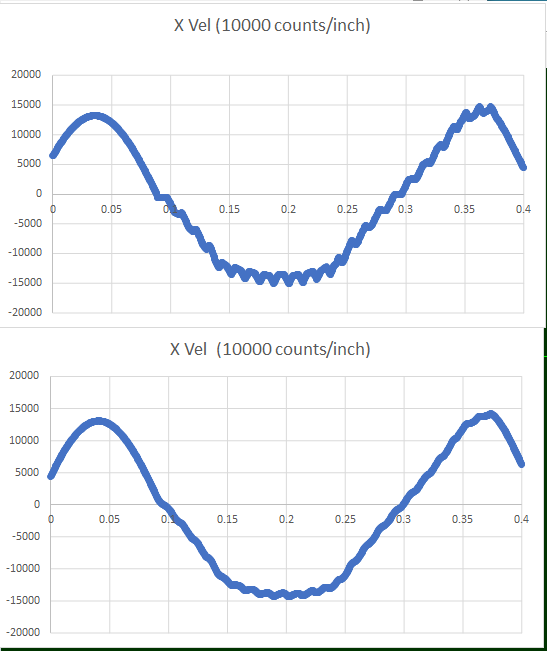

Well now it's a lot smoother.
No audible noise even if I run the test without KLP smoothing.

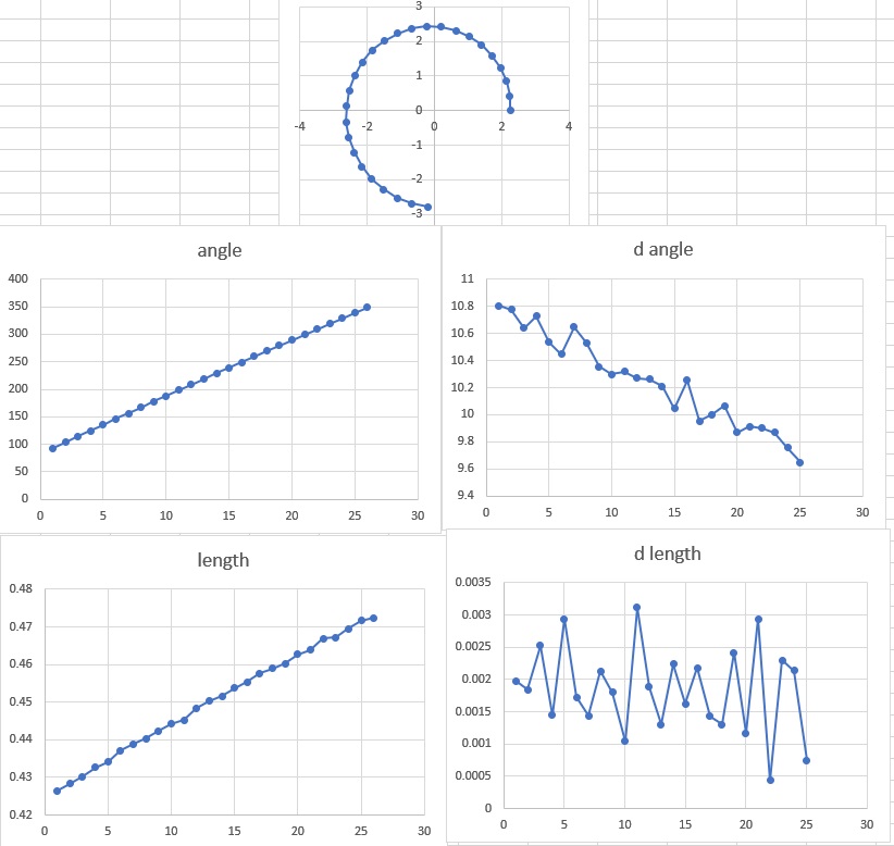

I also acquired motion data as usual and I report the results, in terms of feedrate in the plot attached (In the meanwhile I discovered how to attach pictures inline :D ).
As you can see the velocity plot is a lot more regular. It does not have the braking points at each arc change as before, but there is something strage as well: it seems that some of the arcs created have a sort of slight difference in curvature from the adjacent one leading to a "square wave effect" we can see on the top of curves (where they are limited by acceleration). It is not always the same pattern and way more limited in variation.

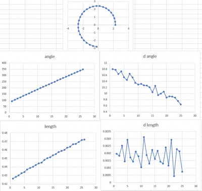

Very strange: maybe a sort of truncation error is going on? It could explain non-repeatable pattern...
Anyway I'll keep testing the whole trochoidal path to see how it runs and then I'll make some chips with it.
Thank you for the quick response and update.
Best regards
Giancarlo
Posts: 2903
Re: Strange Trajectory Planner behaviour
Post by TomKerekes » Wed Mar 10, 2021 7:36 pm
Hi Giancarlo,
I think that is caused by the rounding of the GCode values to 1um. 1um seems small but on short segments it can change the relative length/angles significantly. I plotted lengths and angles of the raw GCode segments:
Can you add another digit in the GCode?
