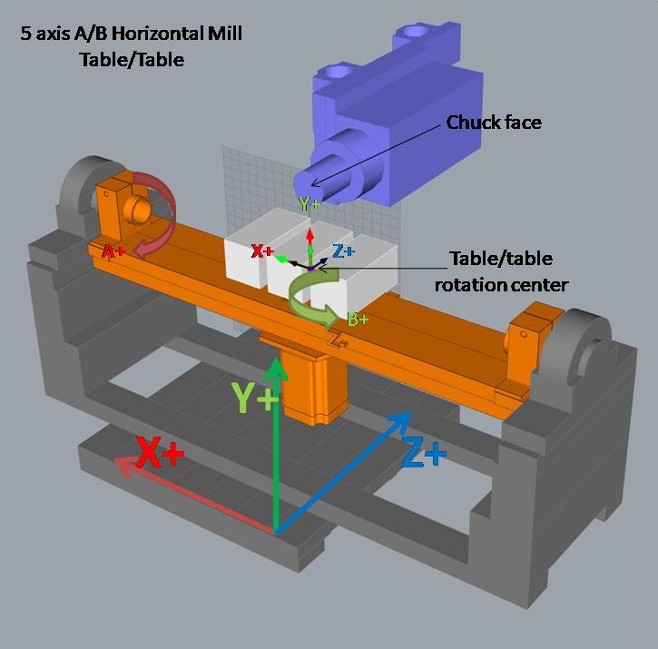

Thanks Tom,
so the rule for the rotary axis is the same as the linear ones: the right point of view is the "pen" so the end mill?
Now my mill is configured as this image:
so according to the "pen" rule I have the rotary axis with opposite direction, effectively in the viewer the linear directions are ok, while the mill graphics moves in the opposite linear directions vs my rotary table.
I had also to change the angular signs (a,b,c) in the kinematics C code (TABLE-TABLE AC & TABLE-TABLE AB), so I believe I should rechange them, in order to be in line with kmotioncnc viewer, correct?
all my best
dd
Posts: 2928
Re: RTCP setup for 5axis A/B table/table horizontal mill
Post by TomKerekes » Thu Oct 01, 2020 9:31 pm
Hi dd,
Sorry I don't completly follow. Are the xyz directions the CAD directions? Or the directions the Table moves? But its probably simpler to try it. I think changing the signs of the angles in the kinematics will mess it up unless you also change the direction the axis moves.
daredevil
Posts: 41
Joined: Sun May 17, 2020 7:39 am
Post by daredevil » Thu Oct 01, 2020 10:14 pm
Hi Tom
the X Y Z directions in the image are the cad ones (the end mill direction), according to right hand rule
while the A & B directions are the table rotation ones (which I believe I need to change)
thanks
best regards
dd

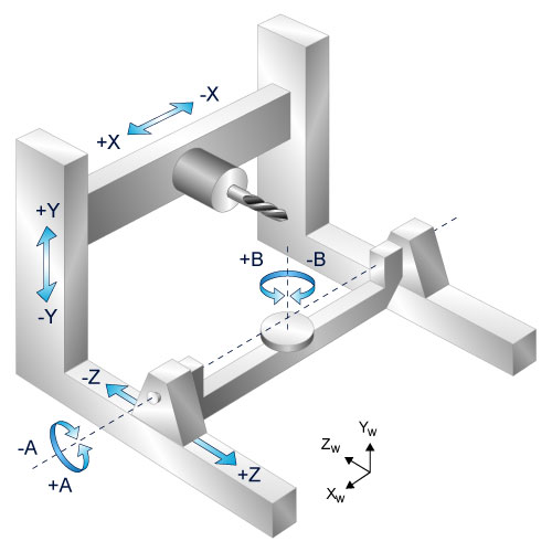

As you can see from this picture taken from infosys.beckoff.com, I found also this AB horizontal kinematics scheme (the same of Pocket NC):
which I follow for my A & B rotary table, but it does not follow the pen rule for rotary axes,
finally the piece is done but the kmotioncnc viewer moves the A/B mill following the pen rule, correct?
just to understand which are the "correct" rotary table A/B sign directions,
thanks
best regards
dd
Posts: 2928
Post by TomKerekes » Fri Oct 02, 2020 3:37 pm
I found this link which agrees with the "pen" method. Says use left-hand-rule for Tables
This shows the GViewer with A at 0 and +20degrees moving as right-hand rule movement:

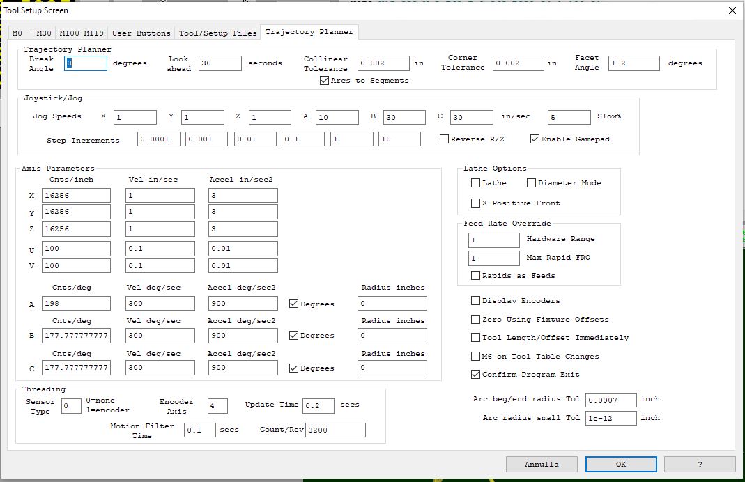

Post by daredevil » Thu Oct 15, 2020 11:45 am
I have some issues with 5 axis continous gcodes, in terms of sustainable feed rate:
- please find attached a simple square inclined 5 axis swarf profile gcode, in the path corners the feed rate slows down dramatically depending on the mm/min feed rate indicated in line #8 of the gcode, to a 4% of the requested feed (i.e. from 500 to 20, or from 1000 to 40 and so on).
please note that I need to put F10.000 to achieve around F380 (always mm/min) in the corners when the rotary axes change more their angles, and the mill motors/axis are ok with this FR (around 400, I have set maximum FR for linear axis around 1700 mm/min).
I run Kmotion 435D sw, please find also attached my INIT C program and Toolsetup kmotion cnc screen.
I kindly ask you how can I obtaine a sustenaible feed rate for this kind of 5 axis operations (my goal could be to have a feedrate around 500-800 mm/min), I believe I need to change the axis setup values in terms of acceleration/jerk? (the velocity seems to be quite coordinated between linear and rotary axis) or what else may I try?
Waiting for your indications,
thanks in advance
dd
