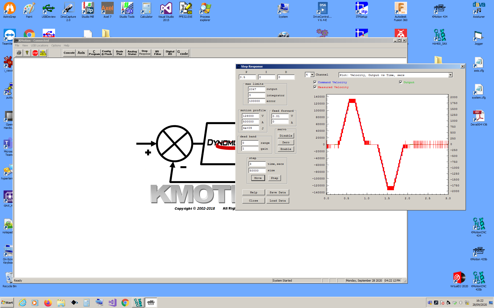

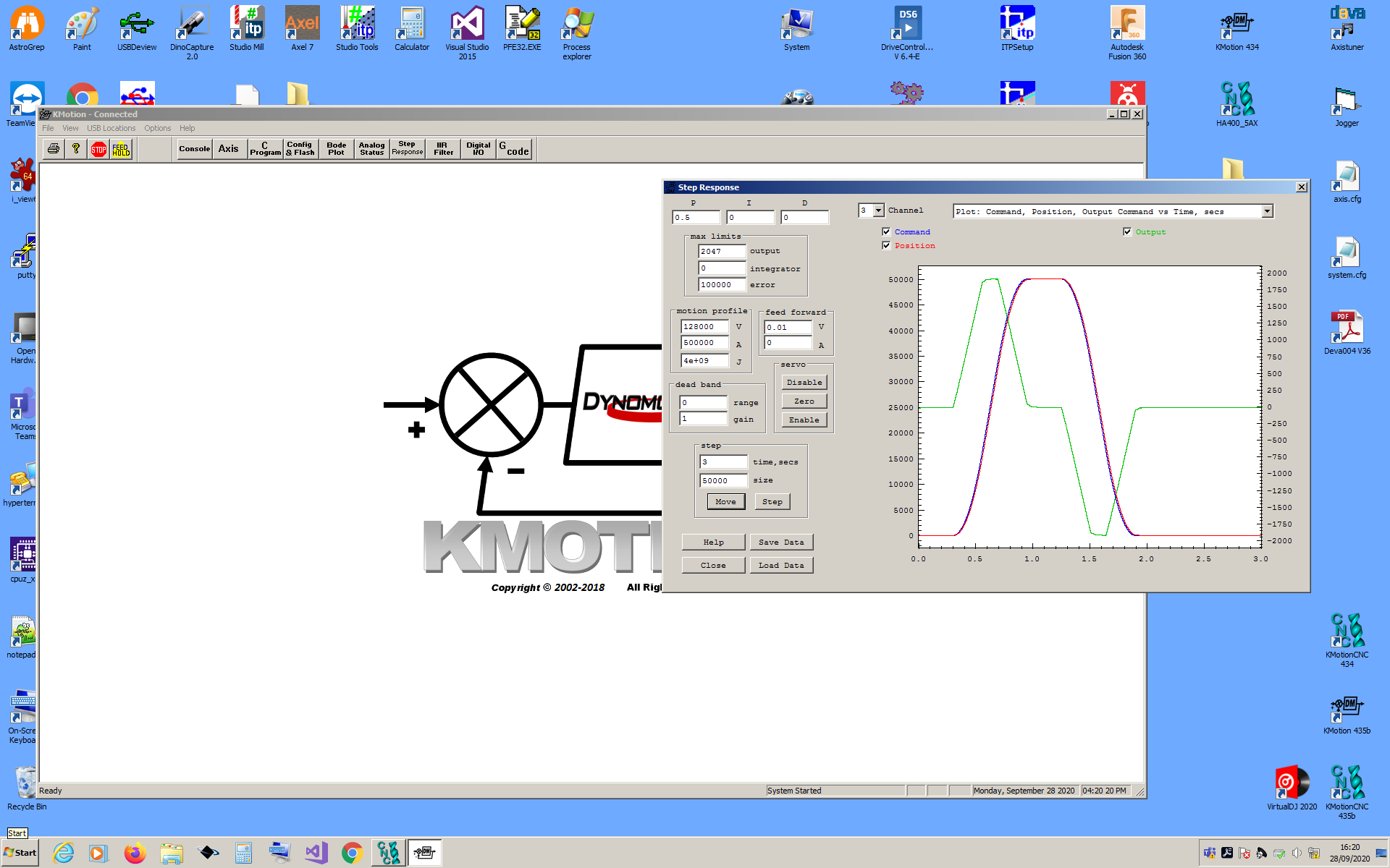

I have only just got to use the machine late this evening.
I was worried about your comment of not using high enough velocities to test the machine.
I have attached motion plots for your comments please.
Tim
Tim

Those moves are just long enough to get up to maximum speed.
What is the resolution of your system in counts/inch or Counts/degree?
Note you can copy a single window vs the whole desktop with Alt-PrintScreen.
Plot Error to see the Following Error more clearly.
