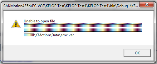

My biggest problem right now is that when I try to execute a Gcode program I get a message box that says "unable to open file ..... \KMotion
\Data\emc.var

KM.CoordMotion.Interpreter.InitializeInterpreter(); <---- I'm fairly certain that this is the call that is failing

Hi Dan,
The KMotion Libraries expect a certain directory structure to be able to find all the executables, libraries, and data files. If you target your executable to be placed into C:\KMotion435b\KMotion\Debug like all our examples then things should work without problems.
Otherwise the Interpreter requires a "var" file to load/save its GCode Variables. A default file called emc.var is located in the C:\KMotion435b\KMotion\Data directory. You can create your own "var" file, place it wherever you want, and tell the Interpreter its name and path using the VarsFile Property.

Thanks Tom!
That has gotten me past this hurdle.
I can tell I've still got a lot to learn on this, but at least I'm moving again.
