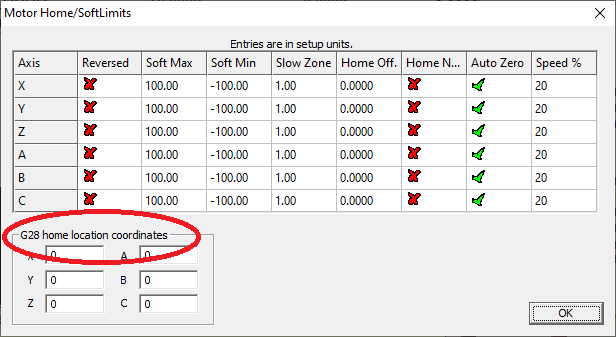

- Posts: 2891
Re: Handling G30 in KMotionCNC and Probe signal?
Hi Gerad,
I think in Mach3 the G28 position is set in Config | Homing Limits
I don't understand what you mean by "MACH3 parameter list".I use Kflop with MACH3 and Schmidt Screen.
Now I tried to work with Fusion360.
The postprocessor from Fusion like to use G28
I have set home offsets in MACH3 parameter list, but if G28
occurs the machine likes to go to 0,0,0.
That only applies when using KMotionCNC not Mach3I have read this parameters for G28 could be set in ems.var if KMotion is used.
I don't think there is a way to change G28 from KFLOP. Depending on how you home you can set 0,0,0 to be anywhere you wish if that helps. To do this set some position at your home location other than 0,0,0Where or how can it be set in C-program on KFlop?
