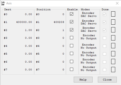

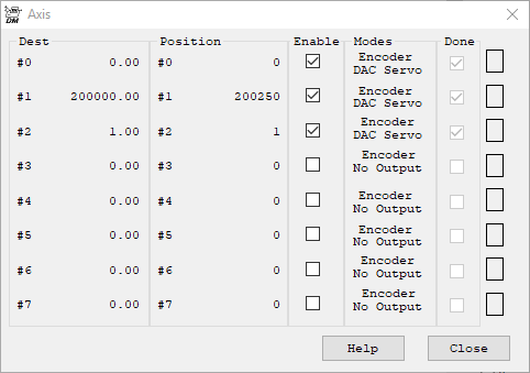

AmitKumar171
- Posts: 134
- Location: India
Re: PID servo tuning of leadshine ELM series AC servo motor with FEEDBACK to KFLOP AND KANALOG
Hi tom,
I tried what you said for PID servo tuning and i have some doubts.
I am using axis channel 1 for my servo tuning axis.
My counts per inch is 50800 counts per inch (2000 counts per mm). I am getting 50 counts difference in encoder position from command direction change using DAC servo system.
In Kmotion.exe axis i have attached images for the problem as well.
First condition is G53 G1 Y0 mm, i am getting 250 encoder counts in position and 0 counts in destination column (axis tab). I gave command of G53 G1 Y100 mm , i am getting 200200 encoder counts in position and 200000 counts in destination column (axis tab). I gave command of G53 G1 Y200 mm , i am getting 400200 encoder counts in position and 400000 counts in destination column (axis tab). I gave command of G53 G1 Y100 mm , i am getting 200250 encoder counts in position and 200000 counts in destination column (axis tab). after I gave again command of G53 G1 Y0, i am getting 250 encoder counts in position and 0 counts in destination coulumn (axis tab). in positive direction i.e. y0 to y100, i am losing 50 counts. (200250 should be the actual value but i am getting 200200)
in negative direction i.e. y100 to y0 , all count are ok. (200250 i am getting)
Please give solution for the above problem.
I already sent the init file in starting of this thread.
Waiting for your kind reply.

- Posts: 2954
Hi Amit,
Homing is the same regardless of axis type. See the SimpleHomeIndexFunctionTest.c example.Can you give some sample c program for index homing c program for DAC servo. as you said earlier.
That would be normal if the axis was not tuned (low P gain and no I Gain). You don't seem to be following or responding to our instructions. Don't run GCode until after you have the Axis configured and tuned. Did you change the InputGain0 to 1? What parts of the Basic Servo Tuning Overview have you performed?in positive direction i.e. y0 to y100, i am losing 50 counts. (200250 should be the actual value but i am getting 200200)
