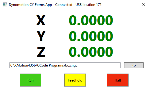

Note there is a C#/WPF example SimpleGCodeWPF but it is extremely primitive:
(oops just noticed the title should say WPF not Forms)
