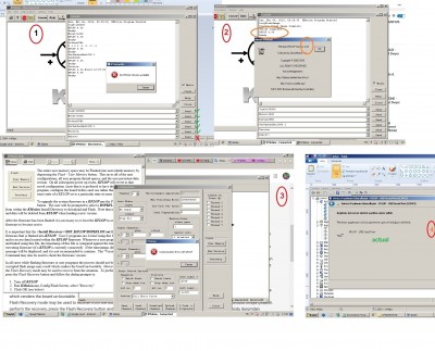

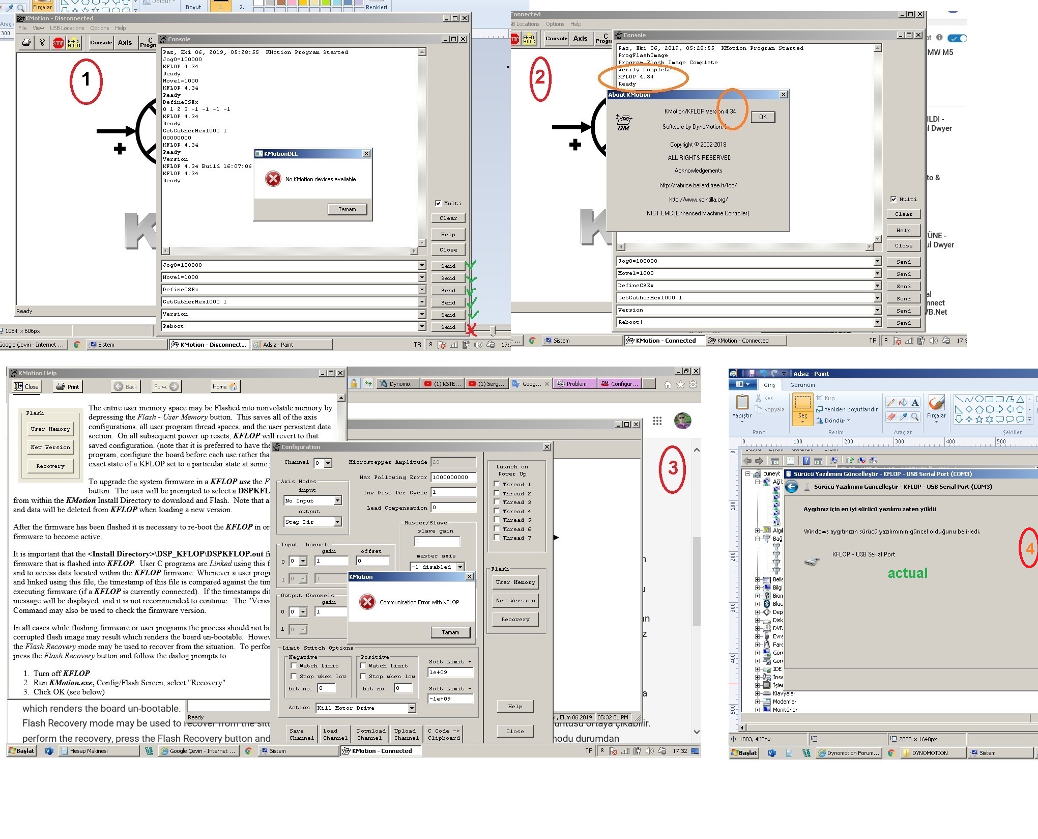

Hi Tom.
I added my problem. I readed pdf. I m not connected Kflop. ( I try, 12 days not working )
I prepare owm 3 axis puls dir c program. ( for stepper motor).
I watched many time kstep KSTEP Introduction - (Getting Started with KSTEP Stepper Driver)
Where can write per step ( I realdy don t undertand that)? I know acceleration and velocity.
Thanks for e stop c program

I don't understand what you are doing or showing. It seems communication is working and you have V4.34. So I don't understand what problem you are trying to solve. When you reboot KFLOP it is normal to lose communication. You should not need the Serial COM Port Driver.I added my problem. I readed pdf. I m not connected Kflop. ( I try, 12 days not working )
