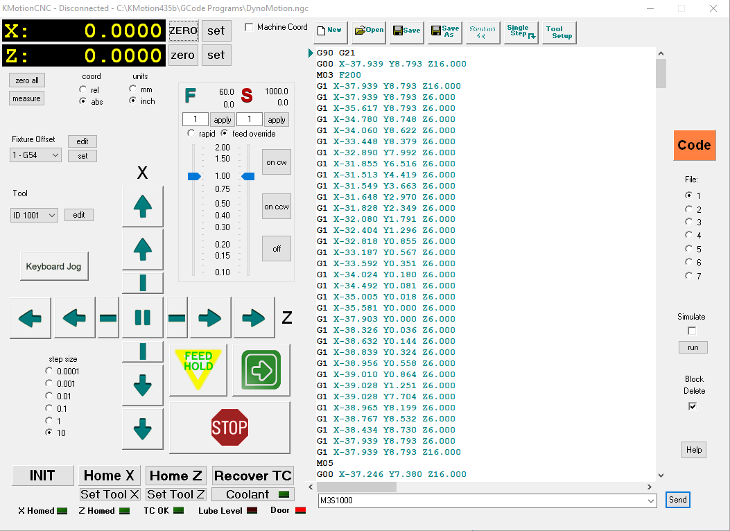

This was the first machine I ever fitted a KFlop too, and although initially running it on Mach3 for the first couple years (my previous lathe ran Mach3 with a SmoothStepper), after yet another crash where Mach sent the unlocked and spinning tool turret into the still spinning spindle, I finally jumped to KMotionCNC. Since moving to KMCNC, the only crashes have been operator error :roll:
I retrofitted it with a KFlop+Kanalog combo, Kinco servos, and added a Click PLC to handle the turret (the Konnect board didn't exist when this was retrofitted, so a PLC was the easiest option).
Cable trunking helps to hide a multitude of sins!
I thought I had more photos, but can't currently find them, but here's a video of the turret working-
The only thing it's had done since the original retrofit and move to KMCNC, is I finally created a custom screen a few months ago to show a few key statuses-

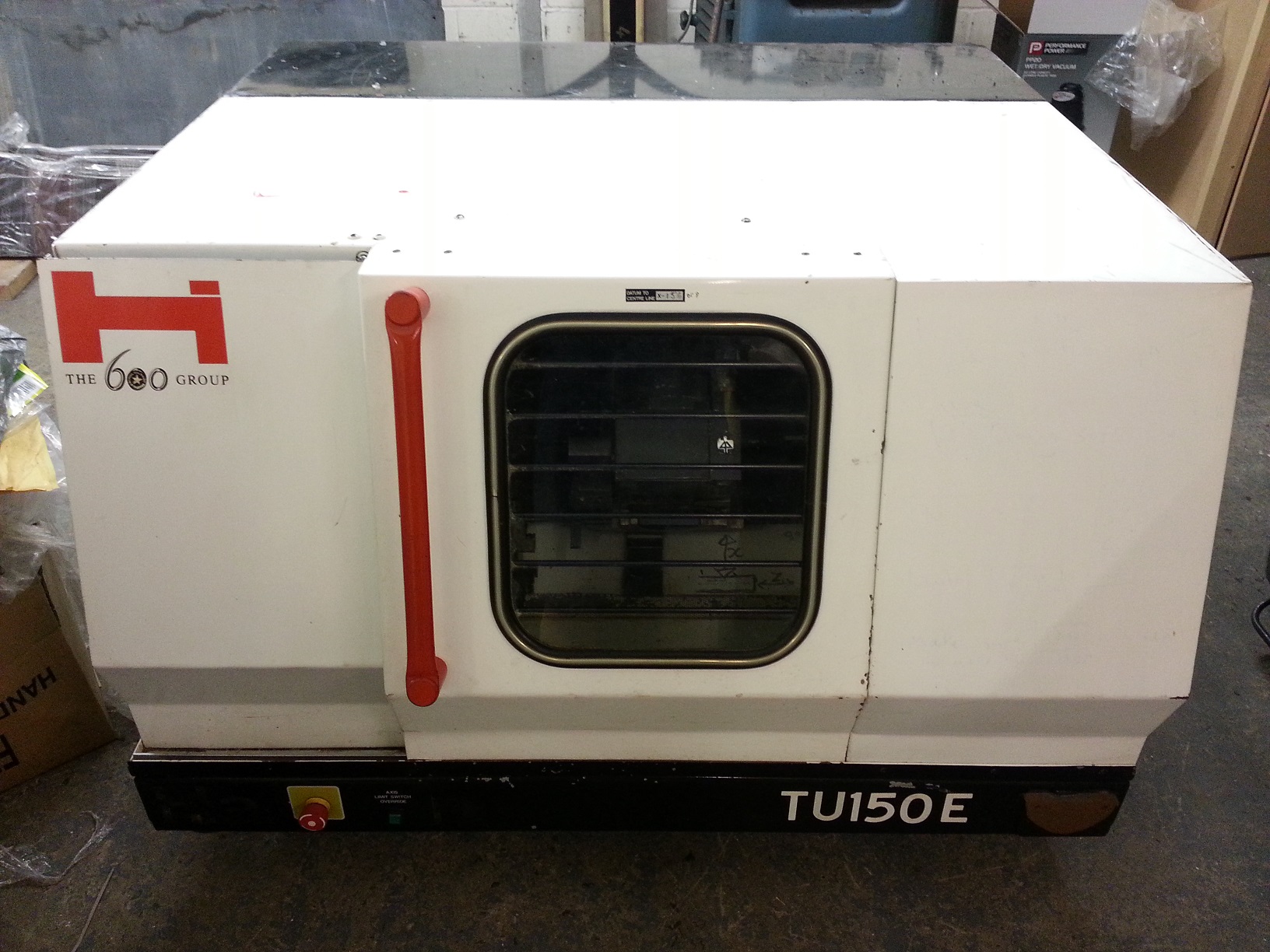

Found a couple more photos.

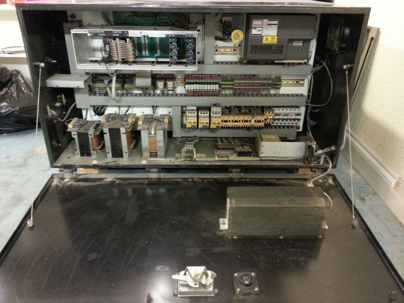

This is the original electrical cabinet-
It originally used a Baldor Eurostep controller with Parker stepper drivers (all rack mounted), along with a custom control card for handling the tool turret.
As part of my retrofit, I replaced the stepper motors with a 700W servo on the Z axis, and a 400W servo on the X axis.

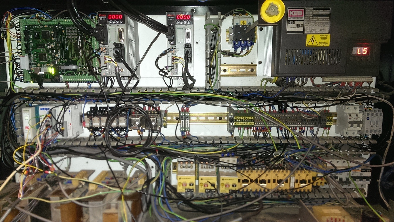

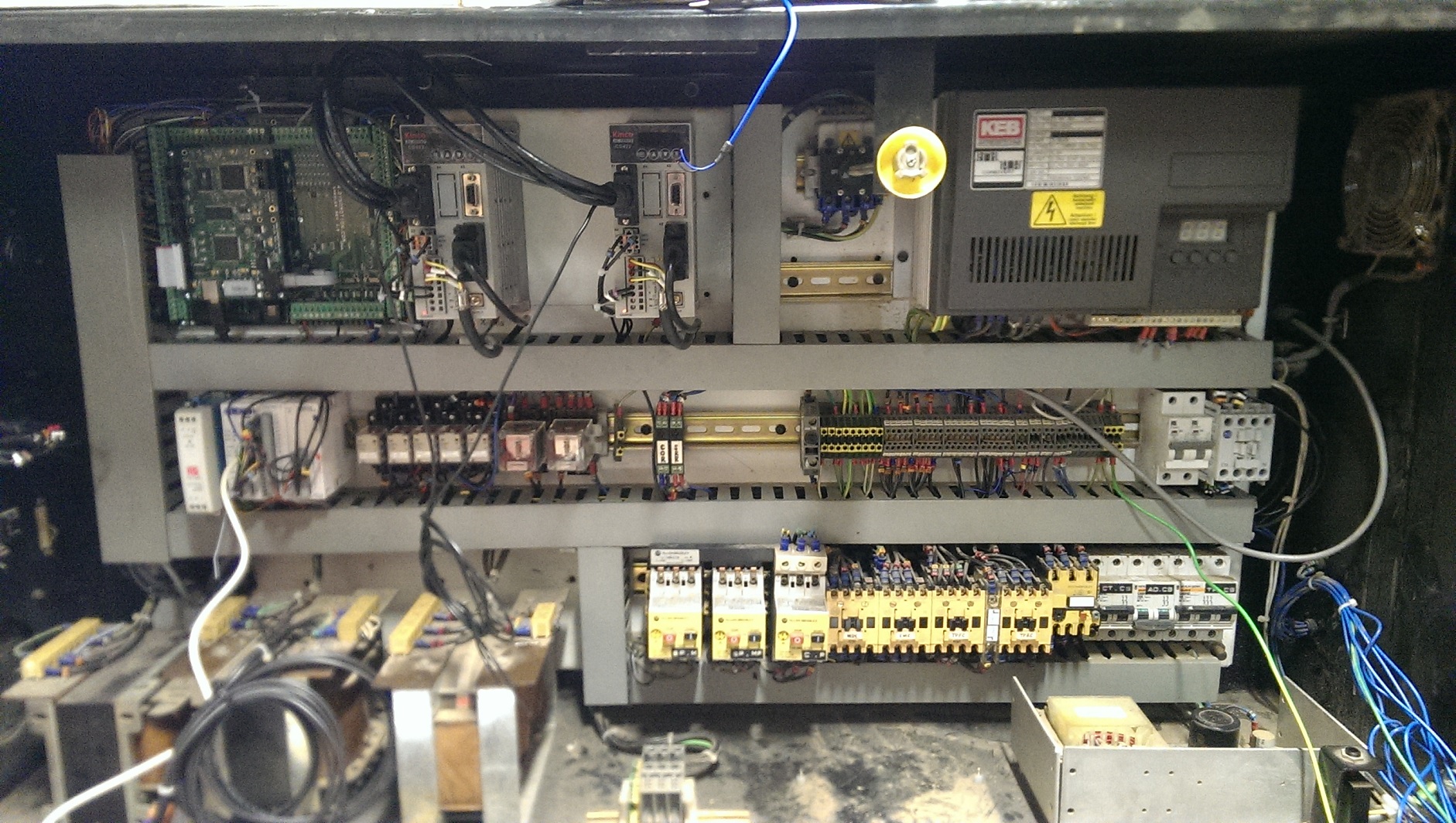

And my comment in my first post about cable trunking hiding a multitude of sins, this was a photo nearing completion, but prior to everything being hidden back in the trunking -
Creating tidy wiring is an artform, which is why I've come to rely on making sure to use large trunking in any new control boxes I've built!
