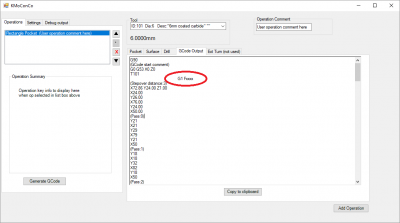

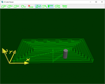

I did seem to find an issue with the "pocket". I think there is a missing G1 and maybe Feedrate:
Otherwise it runs for me:

I knew there was something missing!
In my defence, I done the bulk of the coding for the pocket routine back in March (working out ramp ins in reverse and entry points took me a good few evenings to get right!), and then it got shelved over the summer.
That's now top of the list to fix.

Having just dug into the code, I've realised why I hadn't got as far as adding the feedrate. I'd not finished the CW code.
Fixed version is attached, although it's not perfect as after retracting to clearance Z from the final pass, it goes straight to the start of the next lead-in move, rather than moving then plunging down to the start of the lead-in. I'll add it to the fix list.
