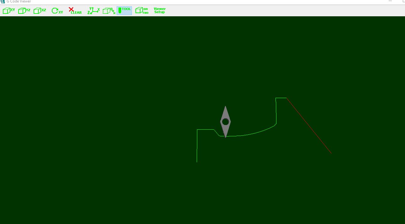

i changed from my custom screen to the basic 2 axis lathe. got the tool path but of course the tool is backwards

on the g code viewer. if i am in basic 2 axis lathe and there is no function to adjust a Y axis value, why is there an elevation difference from the toolpath and the tool? i would think they would be the same plane?

ok, i found the backwards on the radius in my post processor again. :roll:
somehow i can edit in the c gode window too.
my Y axis hovering tool in the g code viewer does remain though. i downloaded a new kmotion cnc on my office desktop and it does not do that. not sure what it is
With a custom screen normally the graphics goes to the GViewer on the custom screen. If you want to use the floating GViewer with your custom screen see here.
I'm not sure what you mean. Maybe you have a Tool, Fixture, or G92 Offset that is non zero? You might add a dummy Y axis to the Coordinate System to display Y and view Machine Coordinates vs GCode Coordinates.
G code and CAM preview
the red line is what the machine tries to cut
You might change try changing Lath Options | X Positive Front.
