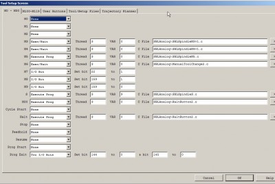

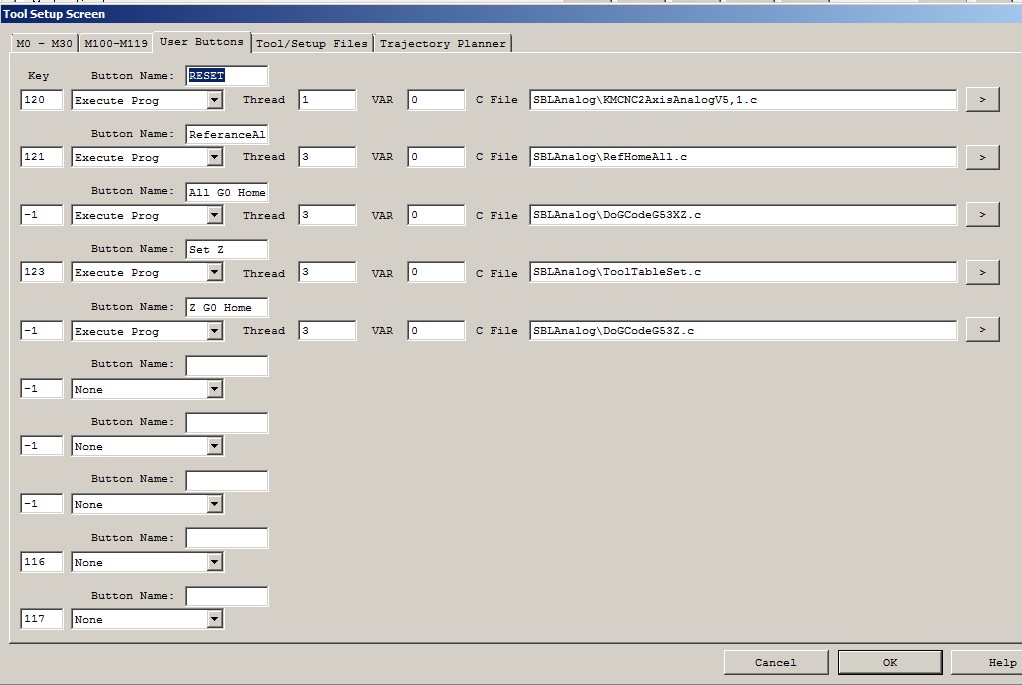

Re: Lathe Tool Z offset
Here is screenshots of my ToolSetUp. My main init code and ManualToolChange code. Note that i dont have CSS in my init yet as i have not figured it out yet.
The reason for another CycleStart after clicking the OK button is so user does not have to go from keyboard or mouse to machine buttons. This is mainly for when user is proving out a new Gcode/Setup and needs both hands, one on the CycleStart and the other on FeedHold.
Troy
Troy
