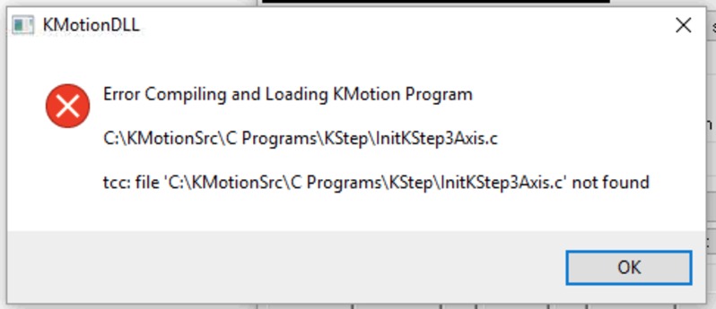

Ok, so I started with the 3 axis KSTEP sample, removed channel 2 (keeping 0 and 1), reorganized the axes for the lathe (Z = channel 0, X = channel 1), etc. I added the same printf line at the top of the main(), compiled, uploaded and ran. Still no message printed. Version returns the correct firmware version, ClearBit:47 turns off the correct LED on the board. Thread 1 is selected in the program window.
When I download the program how do I know that 1) it is downloading and 2) when it has completed successfully? I don't see any blinking LEDs or anything in the program window providing download feedback. I have verified that compiling is working - inserting a rogue character generates an error. Even the 6 arrow "compile->download->run" button doesn't seem to upload the program.
I don't have steppers hooked up yet as I wanted to understand the basics before doing that. The printf should tell me that the compile-upload-run cycle is working properly. Up until yesterday it worked fine.

One last try. I copied and pasted the simple Hello World from the wiki and get nada. Even power cycling does not print Hello World. Version from the console gives the version info, the KFLOP is connected. No compile errors. Can't tell if the program downloads as per my previous post.

Hi Michael,
Power cycling won't execute programs unless they have been Flashed
into KFLOP Memory and Configured to "Launch on Power up".
Strange you are having so much trouble with all the basics. I can't
think of why something so simple wouldn't work unless you are doing
something strange like mixing versions, or have flashed programs to
KFLOP, or have multiple Versions running.
So I would suggest first making sure KFLOP is restored to defaults
with:
#1 Turn off KFLOP Power
#2 Reboot PC
#3 Run \KMotion433\Release\KMotion.exe
#4 Turn on KFLOP
#5 Use Config\Flash Screen to Flash "New Version"
#6 Exit KMotion.exe
#7 Turn off KFLOP Power
Now test executing a program to print to Console
#1 Run \KMotion433\Release\KMotion.exe
#2 Turn On KFLOP
#3 Open Console Screen
#4 Enter "Version" Verify Firmware Version is V4.33
#5 Open C Programs Screen
#6 Select Thread #1
#7 Open file "print.c"
#8 Push Save/Compile/Download/Run (button with 6 arrows)
#9 Check if "Hello World" is printed on the Console Screen
TK

Thanks Tom. I understand about flashing and had actually also tested by power cycling after flashing. I think I'm just cursed, maybe I upset the M*** gods when they caught wind I'm using KFLOP?
So, I unplugged KFLOP, rebooted my PC, ran KMotion, plugged in KFLOP, flashed new version and then shut everything down and restarted everything. I then tested the simple Hello World and that worked this time. I then compiled my work-in-progress 2 axis init program with a printf in it and that also works.
I forgot to mention. I did see the radio button on the program window turn green when I clicked Run. I am seeing that now too and things seem to be working fine.
So at this point I think I have a 2 axis (Z & X) init for the lathe basically configured. I need to finish the electronics box so I can actually test and tune the motors and steps/in on the lathe. This is as bare bones as it gets, 2 stepper motor control, no home or end switches, no spindle control and no eStop. I do have the eStop circuitry wiring in progress but I won't interface it to KFLOP until I get the thing running 2 steppers.

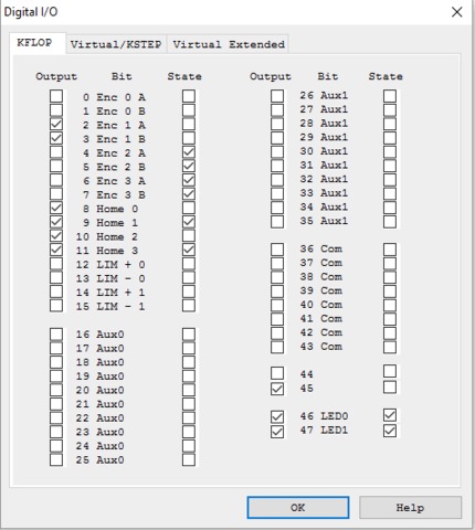

Now that I seemingly have the program uploading, I wanted to see how to go about determining which connector on KSTEP is used for Channel 0 and 1 (my Z and X stepper motors in that order). I opened the digital I/O screen KFLOP tab and I see some - I think - odd behavior. The state bits for 2 Enc 1 A and 3 Enc 1 B are flickering checked/unchecked. I can not uncheck the output box. The 8, 9, 19, 11 home are also all set as output although I've explicitly not configured home switches. None of the state bits are set on the KSTEP tab.
Here's a screen shot of what I see.

Thanks Moray, I understand that about the source you see is not running until you explicitly upload it and run it. I have not even launched KMotionCNC yet!
But as you might see on the post I made while you were posting this, I think I'm seeing some additional odd behavior on just the basic 2 axis stepper control with nothing else configured.

That sounds perfectly normal. When you connect and configure add-on boards to a KFlop, certain KFlop inputs/outputs are used to control the add-on board (in your case the KStep). If you look at the Hardware/Connector page for the KFlop, you'll most likely find all those Bits you've listed relate to the connector that the KStep is using.
As for the KStep State Bits, they'll not show ticked unless you apply the required power to the input pins on JP33.
