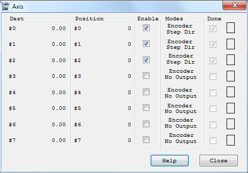

Axis Status Screen
The Axis Screen displays Axis Status including:
- Current Commanded Destination
- Current Measured Position
- Whether the axis is currently enabled
- Input Mode
- Output Mode
- Done Status (no independent Move or Jog in progress)
- Current Bar Graph (if current sensing is available for the axis)
Clicking on Enable will enable or disable the axis without downloading any parameter settings to KFLOP/Kogna.
