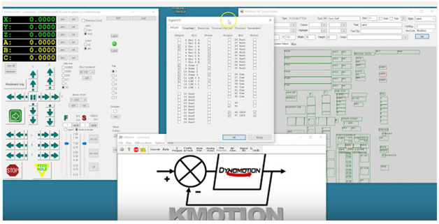

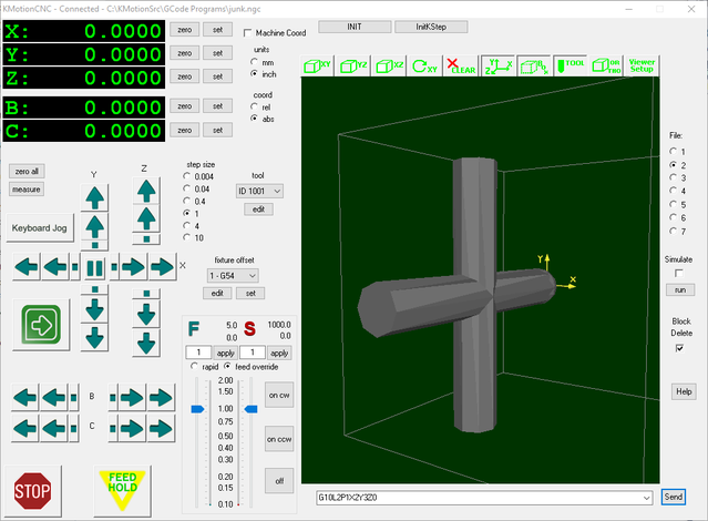

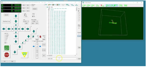

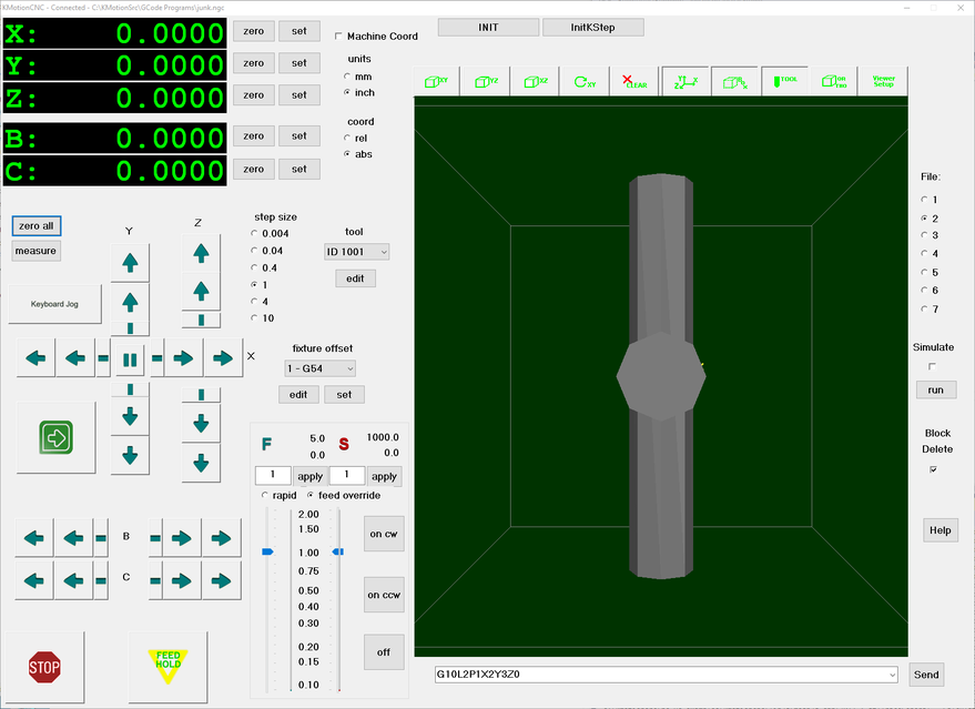

The 6-axes default screen is changed to a 5-axes screen by deleting the z-axis. We start by installing KMotion 4.34b or later. Note that if you don’t already have Dot Net version 4.62 or Visual Studio 2015 libraries installed, you will be prompted to load those. Create desktop icons for KMotion, KMotionCNC and KMotionCNC Screen Editor. Run KMotion and observe the default 3-axes resizable screen.
Close the G Viewer window and change the dialog face to Default Custom Screen with no screen script specified. (Tool Setup):

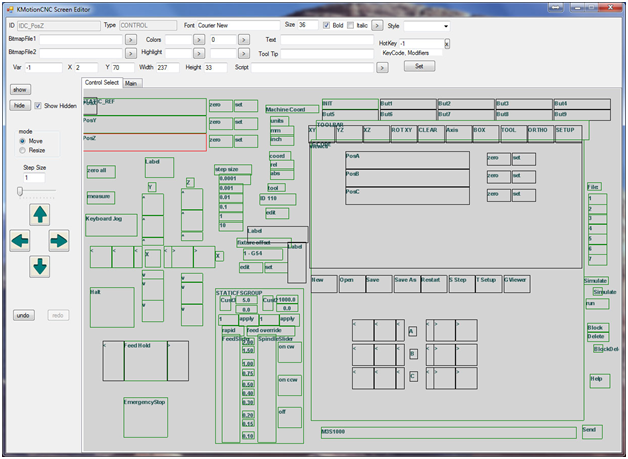

Now run the KMotionCNC Screen Editor. It automatically syncs to KMotionCNC’s controls and they are graphically displayed.
This graphical representation allows you to select which controls you want to modify.
Notice we can select a control and immediately hide or show it over at KMotionCNC. The controls can be moved or resized. There is also unlimited undo/redo. Multiple controls can be selected by dragging the mouse over the graphical display. Click SHIFT to add more controls, or CTRL to remove from the selection.

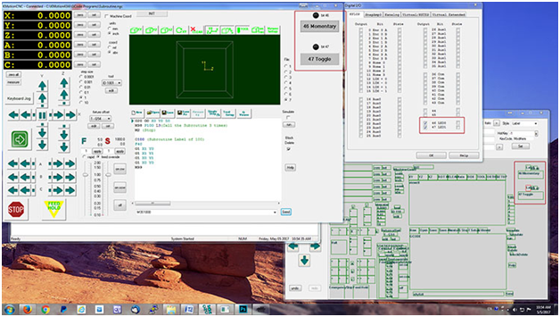

Momentary and Toggle button types in KMotion CNC Screen Editor
https://www.youtube.com/watch?v=eE2mSUXxN2M

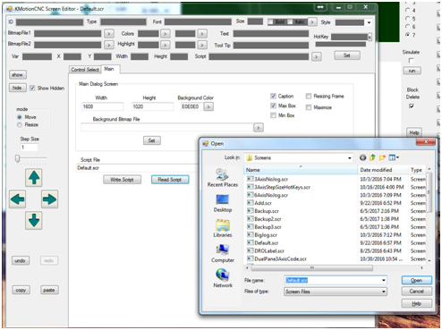

Start KMotion CNC Screen Editor, and click on the “Main” tab, then on “Read Script” and choose the file named MomentaryToggle.scr
You will see two buttons, a Momentary button assigned to bit46 and a Toggle button assigned to bit 47. You will also see two labels to display the status of bits 46 and 47 as LED bitmaps. We also have KMotion displaying the status of bits 46 and 47.
Clicking the Momentary button activates the bit; releasing it, deactivates it. Clicking the Toggle button once sets the bit; clicking it again releases it.

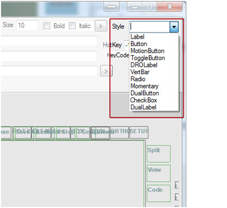

Control styles
Available style options:
  • Label
    Can be text or bitmap. The background is determined by the main dialog background.
  • Button
    Buttons can have all 4 options (foreground and background colors in on- and off-state) or they can also be bitmaps. Labels can load actions/scripts when the main screen is loaded.
  • MotionButton
    Motion buttons are strictly for jog button use only.
  • ToggleButton
    See description above and video.
  • DROLabel
    (Digital Read Out) runs a program in KFLOP, e.g. reads two edit cells in the “Add” example and passes back the result. X, Y, and Z are other examples of DRO labels.
  • VertBar
    Plots a vertical graph from 0 to 100% and is read by KFLOP like DRO labels. See also the Instant Feed Rate Display video.
  • Radio button
  • Momentary button
    See description above and video:
  • DualButton
    https://www.youtube.com/watch?v=8dAEeGnLaRg
  • Checkbox
  • DualLabel
    F for feed rate and S for spindle are example of dual labels. They display the state (one or another). They are fixed and cannot be edited.

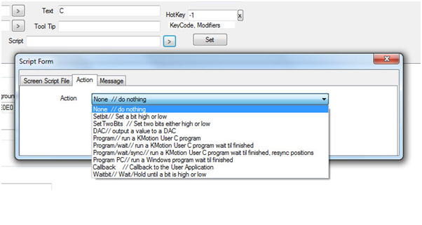

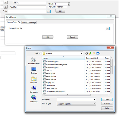

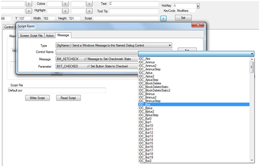

  • Script
    Using this field, the user has three options shown below.
Video demonstration of the creation of Screen Script to perform Windows Messages
Control Script Options
a) Selecting a screen script file from the library:
b) Selecting an Action:
c) Selecting a Windows Message:

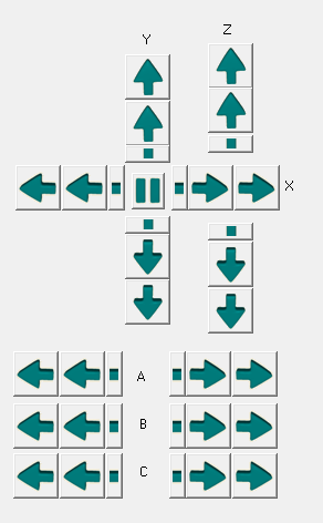

Motion Buttons (for Jogging)
Special Buttons for Jogging exist with Style MotionButton. Although these buttons can be customized with regard to Bitmap images, size, positions, Font, ToolTips, Show/Hide, and Hotkeys they have fixed functionality for the 6 GCode Axes XYZABC.  They support momentary Hotkey and combined mouse operation with the ability to have multiple Hotkeys pushed simultaneously and dynamically change speed using the SHIFT key.  Additional MotionButtons can not be currently added.
The Jog Buttons are grouped into 6 buttons per axis.  3 of the 6 buttons are used for moving one direction and 3 for the other direction.  The 3 buttons correspond to Stepping a fixed distance, Jogging slow, and Jogging Fast.   The Resource IDs corresponding to each axis are:
X + = IDC_RightStep, IDC_Right, IDC_Right2
X - = IDC_LeftStep, IDC_Left, IDC_Left2
Y + = IDC_UpStep, IDC_Up, IDC_Up2
Y - = IDC_DownStep, IDC_Down, IDC_Down2
Z + = IDC_ZplusStep, IDC_Zplus, IDC_Zplus2
Z - = IDC_ZminusStep, IDC_Zminus, IDC_Zminus2
A + = IDC_AplusStep, IDC_Aplus, IDC_Aplus2
A - = IDC_AminusStep, IDC_Aminus, IDC_Aminus2
B + = IDC_BplusStep, IDC_Bplus, IDC_Bplus2
B - = IDC_BminusStep, IDC_Bminus, IDC_Bminus2
C + = IDC_CplusStep, IDC_Cplus, IDC_Cplus2
C - = IDC_CminusStep, IDC_Cminus, IDC_Cminus2
Note the HotKeys for all 3 Motion Buttons for each axis/direction must be set to the same value. This is because the same HotKey combined with CTRL and SHIFT alter the behavior to Step and Fast respectively.  If not all 3 buttons are desired for the screen the others may be hidden but should be all defined to the same HotKey for the HotKey functionality to work correctly.  Furthermore no other buttons should be defined with the same HotKeys.  The Screen Editor has a special feature to test for Duplicate HotKey assignments called "check dup hotkey"
There is also one associated IDC_StopStep button which will stop any Step Movement currently in progress.
Performing an action Immediately within Screen Script
Normally when processing a Screen Script, the "Script" Parameter defines for a Push Button Control what should happen when the Push Button is pushed. However when a "Script" Parameter is specified for a static Label the Action will occur immediately after the Screen Script is processed.
For example: when loading a screen intended for Simulation we might want to have the Simulation mode automatically selected on. So the Script for the IDC_SimulateStatic Label might be set to check the simulate checkbox with:
WinMsg:DlgName;IDC_Simulate;BM_SETCHECK;BST_CHECKED

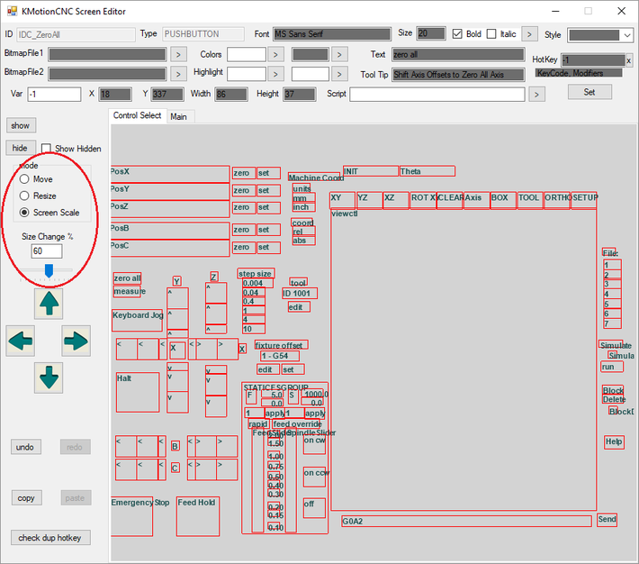

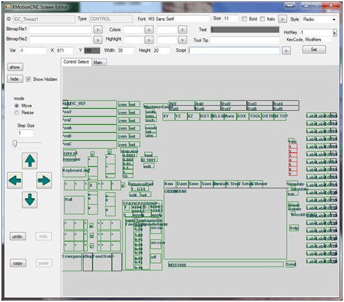

Scaling an Entire Screen or Portion of a Screen
A new Screen Editor feature has been added to stretch/shrink a number of selected screen controls by a specified percentage.  The height and width of the controls can be stretched as with their XY positions.  The horizontal and vertical directions can be Stretched/Shrunk independently.  Scaling the Vertical direction will also scale any Font point settings.  The Width and Height of the entire dialog will also be scaled accordingly.
To Scale a Screen:
  1. Select the controls to be scaled - usually all controls (drag a box to select multiple controls)
  2. Select mode: Screen Scale
  3. Select the desired Size Change as a percentage 1-100% (ie 60% corresponds to a stretch/shrink factor of 1.6)
  4. Push Increase/Decrease Width button
  5. Push Increase/Decrease Height button
Note: it is best to scale in one step vs multiple steps as control widths and font sizes are integers and may have rounding after each step.
Note: any bitmap images will be unchanged and remain the same size.  They can be manually scaled with a graphics app if necessary.
Screen Editor with Screen Scale of 60% and all controls selected:
Example Original Screen:
Example Scaled up 60%
