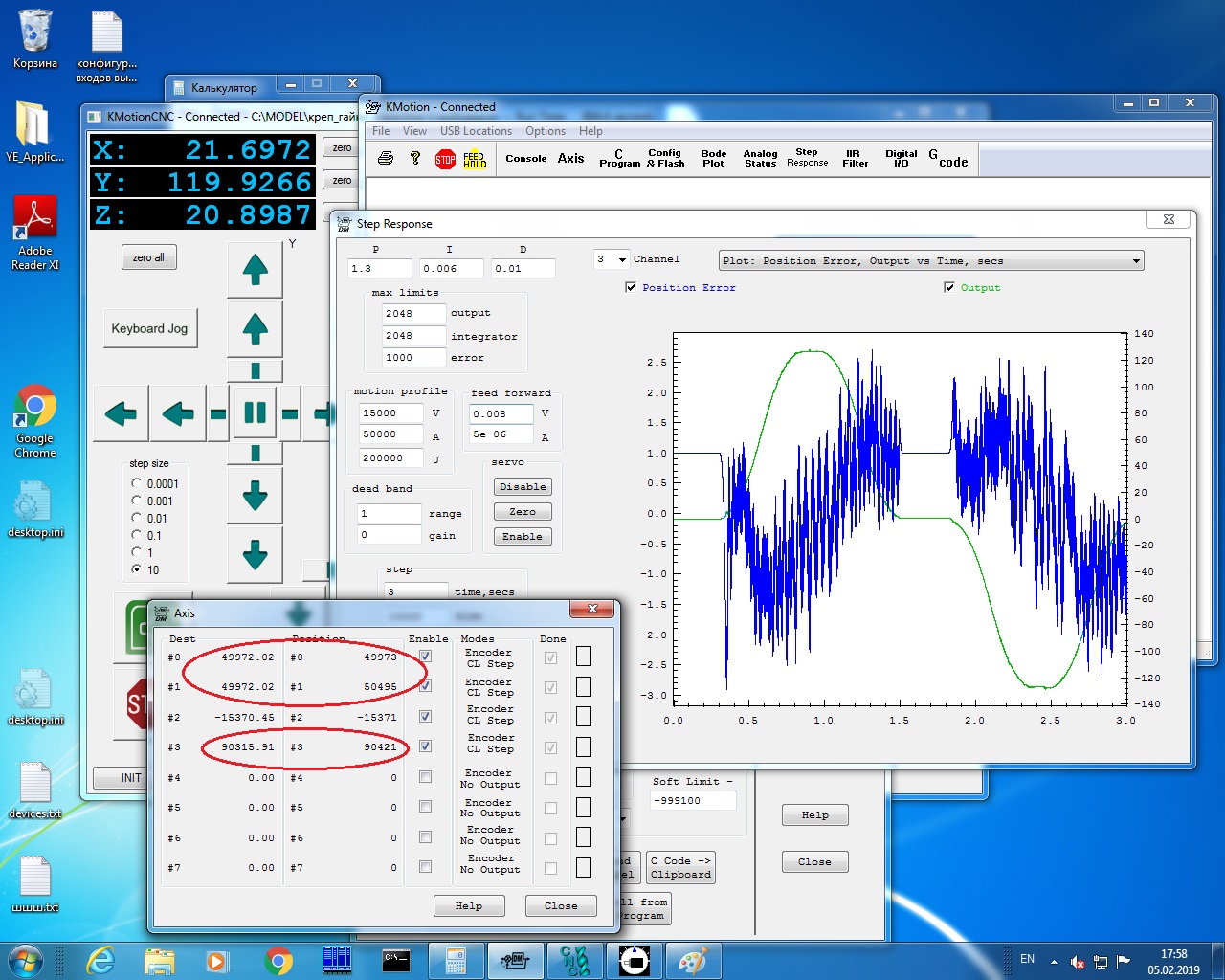

I have problem in G-code program cantaining G2, G3 codes (example attached). Position axis X1, X2, Y exceeds destination for different meanings (example screen attached). And only in mode CLStep. In mode Step Dir all ok.

If I test axis in CLStep mode in step response - all axis go from 0 to 0 every time... i'm dont understand how its may be...
How can it be after the eng G-code pogram Dest axis 3 = 90315 and Pasition axis 3 = 90421?

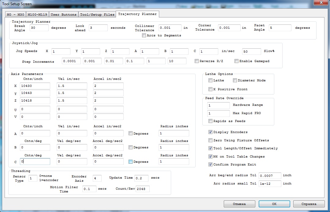

IIR not using, traecory planer in attachment.

Those Trajectory Parameters look reasonable. Possibly the acceleration is very low:traecory planer in attachment.
2 in/sec2 x 1G/384in/sec2 = 0.005G
High speed machines are often 10X or more higher.
