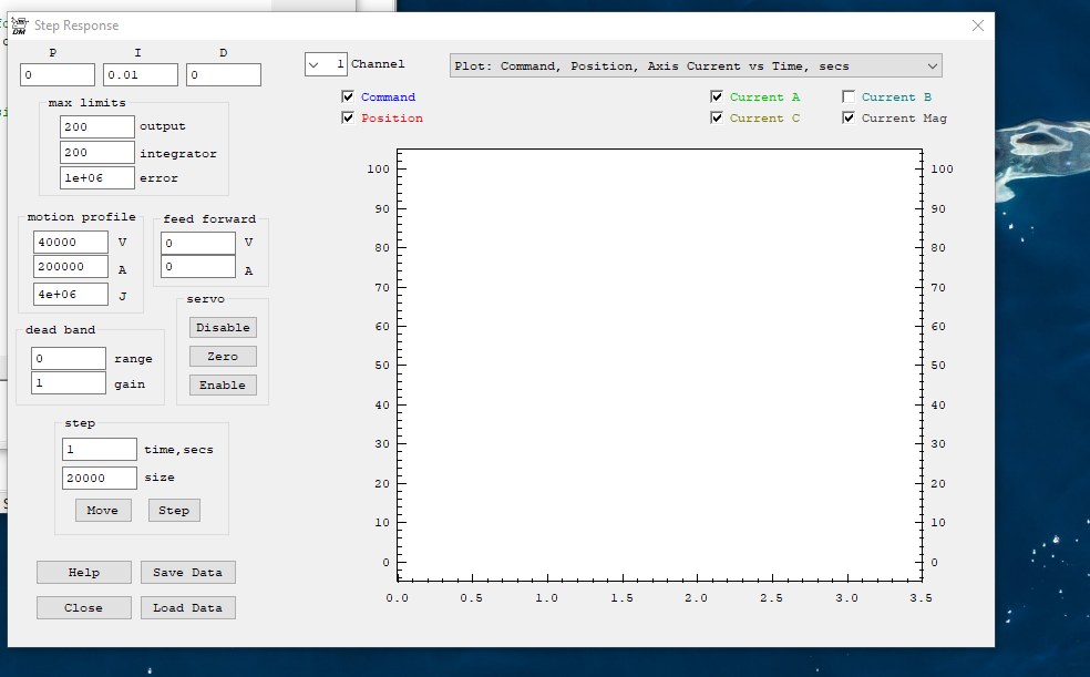

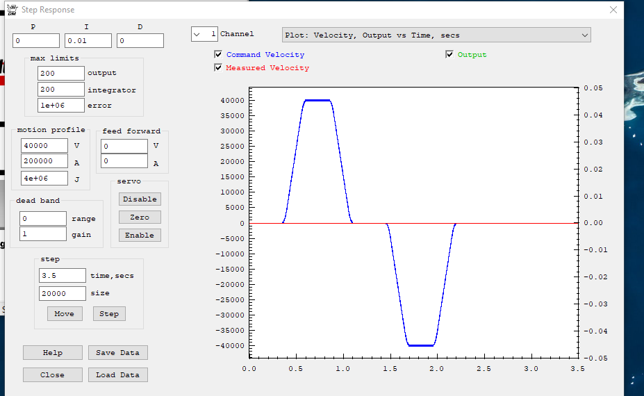

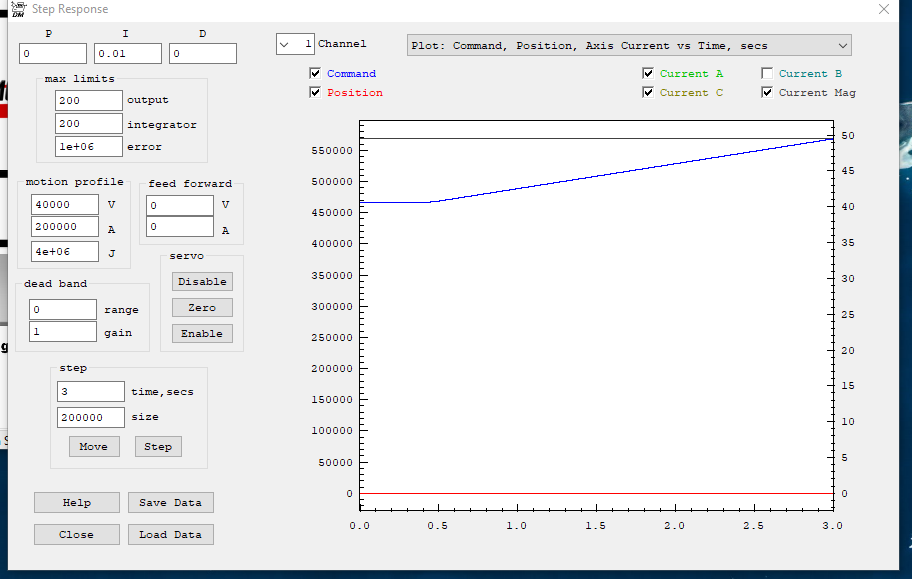

Itook screenshot of the step response but don't know how insert them.

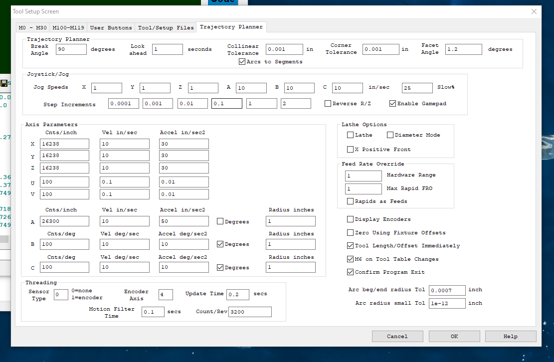

I don't see anything unusual. Post your KMotionCNC | Tool Setup | Trajectory Planner Screen so we can see the axis resolution and Jog Speeds.

I changed the jog to .75 on the y axis and the growling disappeared. Not sure how that is going reflect maximum travel speed when I run a program.
I will continue to for mechanical binding but since it works great in step response for moves of 10 inches +- . Thank you for all your help. Happy Holidays

I see the Axis Parameter Speeds are limited to 10 inches/sec. That would be 162380 steps/sec. But you are only testing 40000 steps/sec in the Step Response Screen so maybe you should reduce those. This won't matter unless you command a Feedrate higher than the limits. Similarly Acceleration is set at 30 inches/sec2 but you only test 12.32 inches/sec2.
