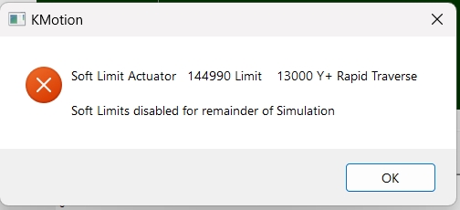

Hello, I've encountered an issue while running G codes that were previously functioned correctly but now consistently displaying this error message. The only modification I've made recently is to the initialization code, which sets up my stepper motors and configures each axis.
The error is:
Soft Limit Actuator -284272 Limit -13000 Y- Rapid Traverse
Soft Limits disabled for remainder of Simulation
(screenshot also attached)
I tried commenting out my soft limits codes or setting them to really large numbers but still shows the same error.

	//definecoordinate
	DefineCoordSystem6(0, 1, 4, -1, 3, 2); // define axis chan numbers to use as x,y,z,a,b,c (set -1 to disable)

I'm attaching the G code I'm using as well if that helps. Thanks!

Posts: 2955
Re: G code error
Post by TomKerekes » Mon Mar 11, 2024 4:18 pm
Hi Katie,
I think you might be running the Job in inches mode where the comments show a G21 for mm mode.
