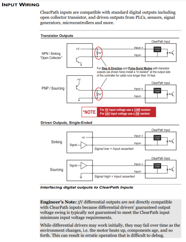

Here is the manual, I did add some resistors like the attached image. Two resistors wired directly to the Step / Direction inputs on JP5 connecting to 5V+. Didnt change anything.

The Drive accepts Quadrature Input Mode as does KFLOP. You might try that as it eliminates certain timing issues.
But then if it only occurs with the Spindle running it is likely noise from the Spindle.
