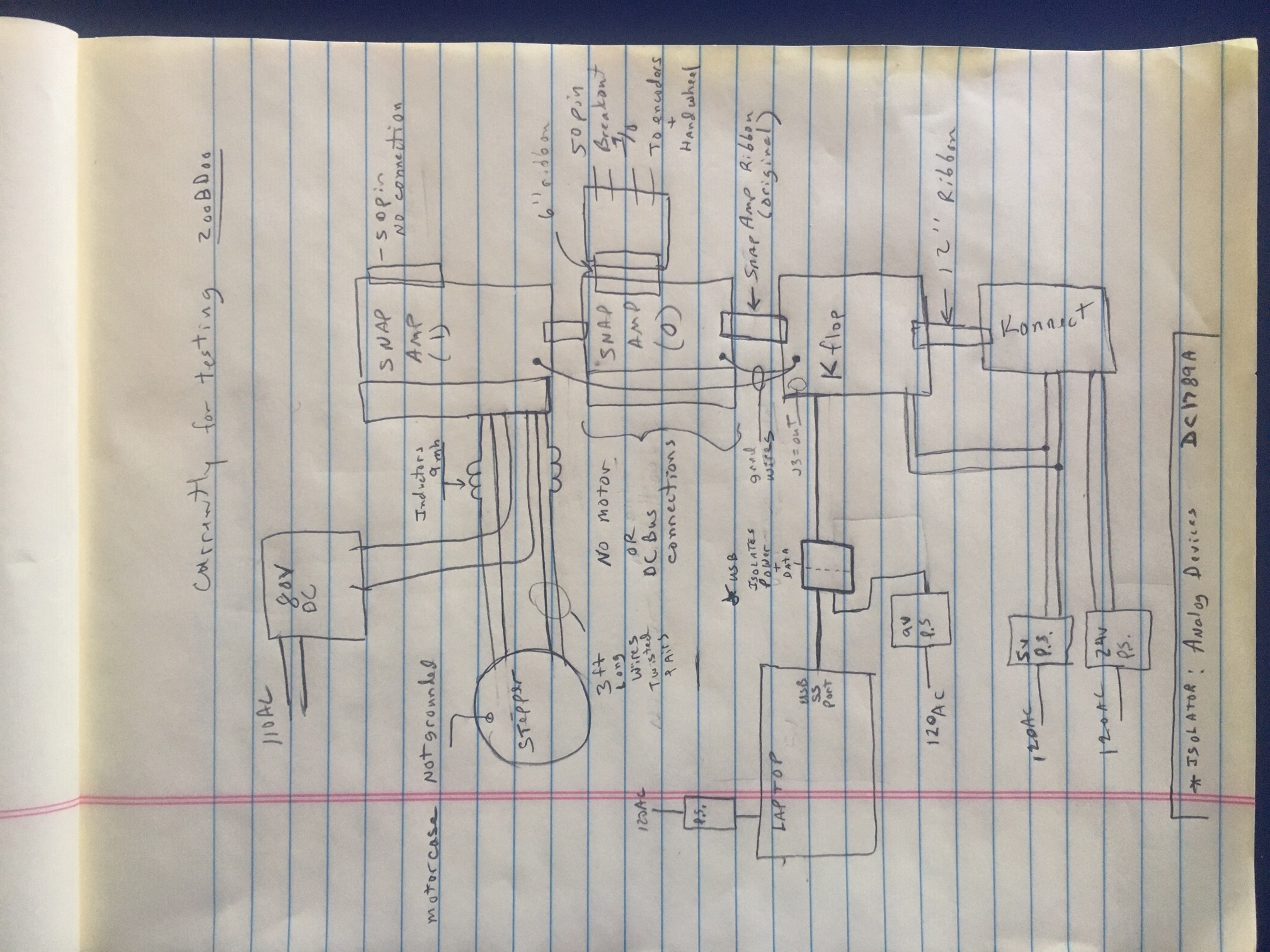

Regarding noise/disconnects. You might see here. Can you describe/diagram your grounding and shielding? Are your supplies isolated? What current are you running the Steppers at? Can you tell is KFLOP is being reset or is only the PC disconnecting the USB? You might turn off an LED that will turn back on if KFLOP resets.

See attached sketch. It's wired this way currently to isolate the issue. There are other motors but they will be running on the other SnapAmp and are not connected now. None of the power supplies are grounded. The stepper motor frame is not currently grounded but will be once mounted on the machine, as will be the other motors / encoders.

What Rev of KFLOP do you have? Rev 1.3 (years ago) add more filtering on the Reset. Most of the KFLOP connectors expose Reset on one pin. If this is connected to a long wire/cable and noise or cross talk affects it a Reset can occur.
One possibility is the 5V Power Supply and/or its wiring. What is its rating? Could it be overheating or intermittent? How close is it to KFLOP?
The 50 pin breakout also has 5V (and GND) going to your encoders and hand wheel. You might remove that as a test to see if noise is entering there.

I have a hard time seeing anything but the stepper setup causing the problem because if the Stepper DC bus is disconnected the problem goes away. Both servos running will run for hours. The stepper system is so compact and there is nothing there but SnapAmp, Kflop motor and 2 feet of motor wire that is no where near any other wiring. No feedback wiring, no shielding, No grounding. It seems that there is no external path to generate a reset so it must be coming from within the boards.
I agree that the K flop is being reset and I keep thinking that it has something to do with the little ground wires running from the the Snap Amps to the K flop. Or that there are two SnapAmps and somehow with the two of them running they will occasionally get into a PWM "Beat frequency" that permeates the system and causes a reset. But I keep getting back to the fact that it only happens with the stepper in the system no matter how the dual amps are configured. The symptom seems to follow the stepper and I've tried with two different stepper motors, different brands etc. so that would seem to eliminate power supply issues or other wiring.
If I install a filter cap on one of the ribbon cable connectors RESET lines, would this same capacitance / filtering be "seen" on all the other reset lines to the other connectors or would I have to install a filter at each connector??
I will also try running it without the 50 pin breakout. As you can see in the sketch, the only connectors on the K flop are to the Konnect and the SnapAmps. I'm going to completely remove one of the SnapAmps to see what happens if I run one SnapAmp with the stepper. I ran a system with two steppers on a Snap Amp about 6 years ago and never saw this problem. Report coming...
