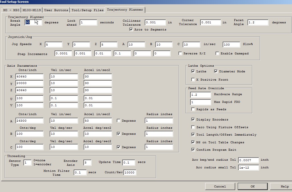

Posts: 2942
Re: CSS on Lathe
Post by TomKerekes » Sat Jun 08, 2019 1:56 am
Hi Troy,
The code inside the file CSSJog.c is basically only a function that is meant to be included in another program (your KMCNC2AxisAnalogM6 V5,3.c). It can not be compiled as a program on its own as there would be no main function and other header files aren't included to define things. To compile it and check for errors compile the program that includes it.
On a note unrelated to your problem I believe the KMotionCNC | Tool Setup | Trajectory Planner | Threading | Spindle axis is incorrectly set to 3 instead of 7.
tmday7
Posts: 51
Joined: Fri May 11, 2018 10:17 pm
Re: CSS on Lathe
Post by tmday7 » Sat Jun 08, 2019 2:30 am
So its not were i have the encoder connected to on the Kanalog board?
Troy
Posts: 2942
Re: CSS on Lathe
Post by TomKerekes » Sat Jun 08, 2019 7:09 am
It is the KFLOP axis that is configured to read the encoder channel it is connected to.
