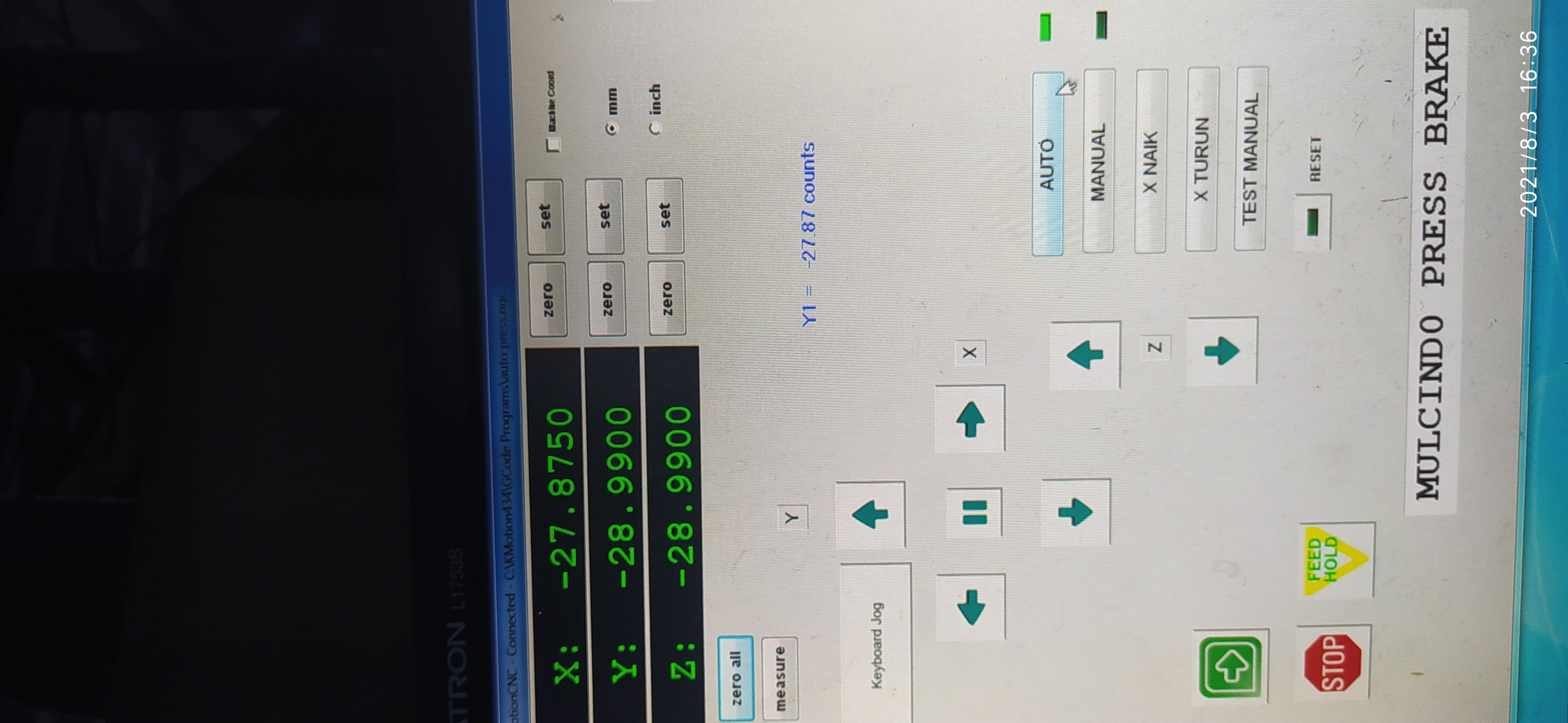

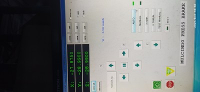

i love dynomotion, I can already display the Axis X indicator ( Y1 )

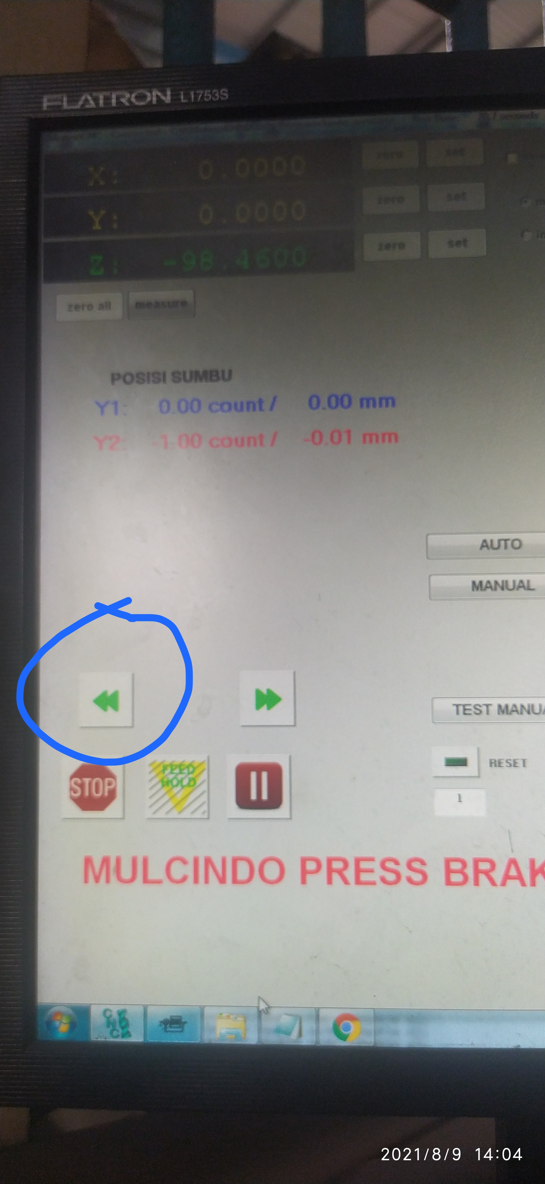

how do you get forward and reverse (feed hold) connected to the C program, sir? because I want to activate the relay up.TomKerekes wrote: ↑Thu Jul 29, 2021 3:32 pmSorry I still don't understand the question.
No if the GCode is moving down you can't move up.
Actually if you Feed Hold you can reverse the GCode.
Although with your machine if you need to switch relays to change directions it may not work.
then how to make an external button for reverse (feed hold)? because I don't know the command to enable reverse in C program. I tried to write DoPC(PC_COMM_REVERSE) but it didn't work.

Line in the example I asked you to look at it would be something like:
DoPCFloat(PC_COMM_SET_FRO,-0.2);

sir, what is the difference between these two commands.
and
earlier I tried to write SetFROTemp (-0.2); when in feedhold, and the axis can move up, only the movement falters. such as less stable acceleration and velocity.
how to make the movement when going up, the movement is smooth and a little fast?
and which command from the two codes above is better and suitable for press brake machines?
to continue the g code after the feedhold is released, the movement is smooth according to the feedrate that I specified in the g code line. only sometimes the plate bending results change degrees. but not much.
SetFROwRateTemp <F> <R>
SetFROTemp <F>

Hi irmad,
The first command allows setting the rate to go to the new feed rate. That shouldn’t be needed on a machine like yours.
To reverse faster use a larger negative number like -0.5
Maybe you need to change your pressures when reversing?
