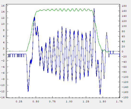

Here goes the output for 4m/min. (Very bumpy, i can't hear any noise.)
4.5m/min and 5m/min goes very smooth.
Also for 29m/min.

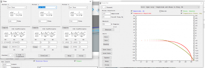

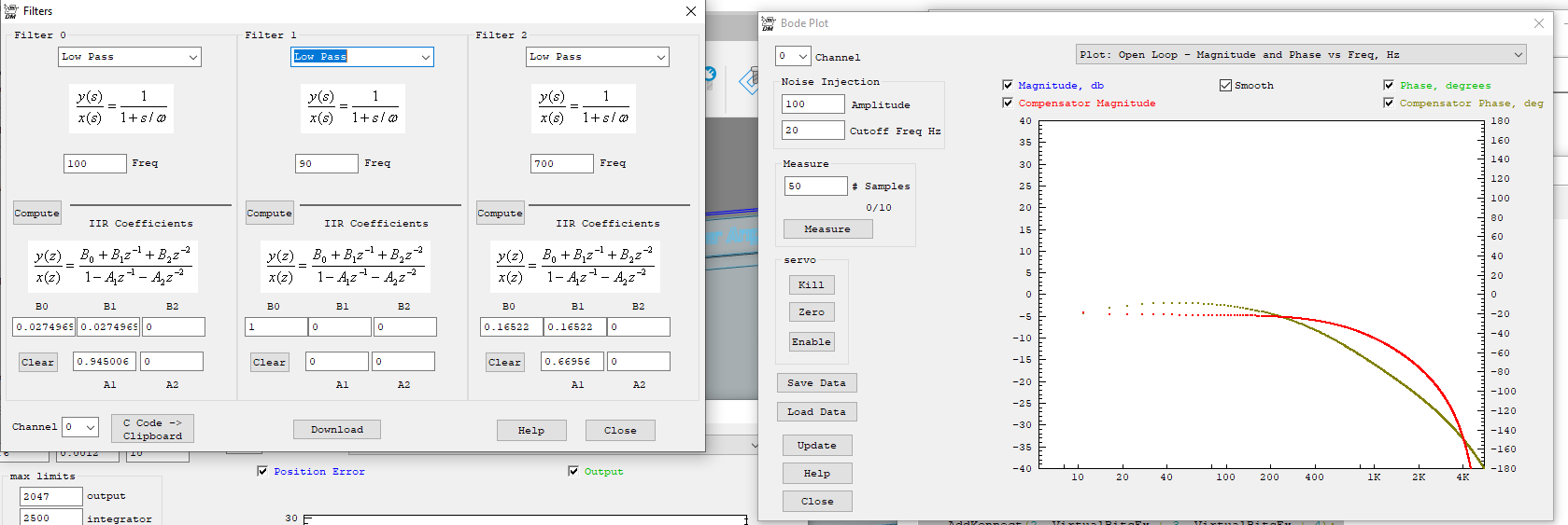

Check the attached photo. i need to lower the Gain to raise D. what can i use?
I don't understand the question.
is ok to use for example a low-pass filter of 300 ?
I often use a 2nd order low pass filter of 500Hz Q=1.4 in the last Filter #2 and clear #0 and #1.

Did you find any anormal motion in the above graphs?
I can post a photo of the part with a lot of bumps if you need.
Thanks!!

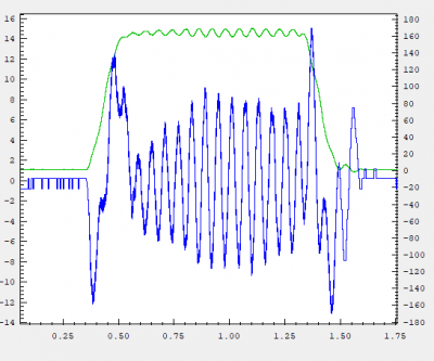

I see an oscillation at ~ 17Hz
So, I should use a pole-zero filter to increase gain in this region ?
Do you have any suggestion to what I can do?
I already tried several options and can't find a way to solve it.
What have you tried and what were the results?
You might do some math to determine what is at that frequency. Your system may have a resonance at 17Hz. You might hit the axis with a rubber hammer and check if it oscillates at ~17Hz. You might also do this while capturing a Plot of size zero. And it may have an unbalanced lead screw or something that excites this when rotating 17 revs/sec. What speed is the Motor or leadscrew rotating at the problem speed of 4m/min?
I doubt if a filter would help.

Nothing seems to match the frequency. Unless its some multiple. 250RPM / 60 x 4 = 16.7Hz. You might also try double or half speed.
I doubt if the servo can correct for that at 17Hz. As a rule of thumb to correct for errors of a frequency the servo bandwidth needs to be like 10X which would be 170Hz in your case. I doubt if you can achieve that.
Like I suggested you might run experiments and see if you can identify the cause and if it really is a resonance and not servo instability. Servo instability is not usually triggered at a particular speed. You might reduce gains a lot to make a very stable (yet not very accurate) system. If the oscillation is still there then it is not likely servo tuning.
A resonance is normally caused by a mass (actually 2) and something acting like a spring. Your belt might be a suspect.
