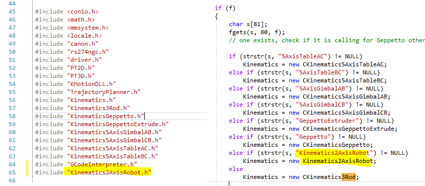

Very good, I made all of the changes you suggested. Here is my updated code, and some screen shots of the StdAfx.h files and CoordMotion.cpp.

Regarding StdAfx.h: It would make more sense to include your kinematics .h file before GCodeInterpreter.h like the other kinematic headers. The idea is to define things in the order they are needed. If the GCodeInterpreter.h references your class it wouldn't be defined yet.
Regarding CoordMotion.cpp you forgot the beginning C in the class name.

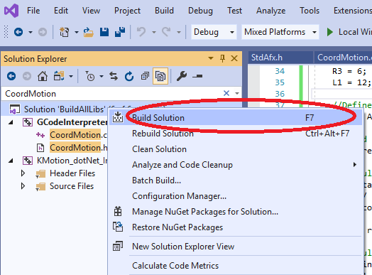

I have some help over the weekend figuring out how to rebuild the libraries. Though it looks like it is as simple as pressing F7?
Yes but not sure why the hot key is F7 for you. It is something else for me (ctrl - shift - B). Maybe you selected something different than me when installing Visual Studio. It simplest to just use the menus anyway.

One more thing that might be confusing is that to fix a bug you must:
  1. Stop debugging KMotionCNC
  2. make the change to the kinematics file and save it
  3. return to the BuildAllLibs solution
  4. Build the Solution
  5. Start debugging KMotionCNC again
Its usually simplest to run 2 copies of Visual Studio. Have the BuildAllLibs solution open in one and BuildExamples solution open in the other.

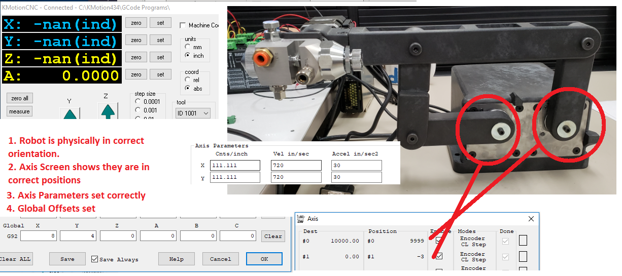

All the hardware is here, and I have been building this robot but am having some problems. Here is what I have done so far
1. Made an INIT program and calibrated each servo motor
2. Made a homing program - homes to a hard stop, and then moves motor 1 to 0 degrees, and Motor 2 to 90 degrees
This position is equivalent to X=8 and Y=4
3. Tested KMotionCNC in Debug mode - my math all matches Excel all works
4. Recompiled all libraries in Release mode
5. Set Cnts/IN for X and Y Axis in the trajectory planner
Now for the problems:
When I start KMotion CNC the X and Y positions immediately display "-nan(ind)". I noticed while debugging that if I put Zero on for my x or y values I would get the same error in visual studio. So I think that KMotionCNC is sending a fixture offset position that is impossible for the geometry to work. I tried all of my fixture offsets, but cant get anything to work.
Maybe there is something wrong with my homing program? I really dont know what else I could be doing wrong. Would you mind taking a quick look at my homing program? My intent is when M1=0 and M2= 90 that X=8 and Y=4. I think if I fed those numbers correctly the math would work out.
Does that sound right?
Thanks!
Scott

Still working on this, here is an image for some additional clarity.
