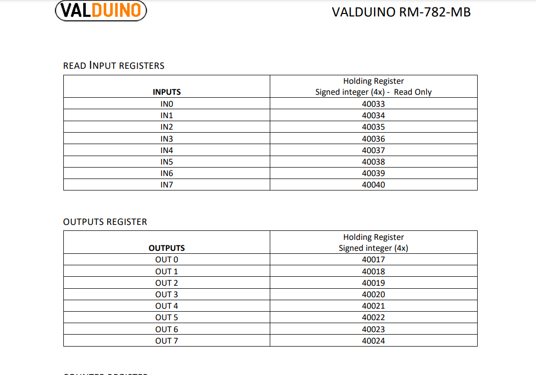

I have RM782MB I/O mudule, baud rate 34800 , slave ID:10 please give me
example for read inputs code, I don't found any solution for this module...

Attached is an example that should read the 8 Inputs to Kogna Virtual Bits 48-55 and write Virtual Bits 56-63 to the outputs Using Kogna's RS485 Port. It is untested. Your example doesn't help much because the library functions weren't provided or documented.
This table defines the ModBus Commands
ModbusMaster_Cmds ModbusMaster_MonitorList[] = {
	// string is "dev,cmd,adrhi,adrlo,lenhi,lenlo" bytes of modbus command. bytelen, data, and checksum are added as necessary.
	{"\x0A\x03\x9C\x61\x00\x08", 6, 0},	//ID=10, Read Holding Registers as inputs to MBRegisters[0-7] starting Modbus address 40033 decimal
	{"\x0A\x10\x9C\x51\x00\x08", 6, 8},	//ID=10, Write MBRegisters[8-15] to Output Holding Registers starting Modbus Address 40017 decimal
	{0, 0, 0}					// end flag
These functions move the ModBus Register data to/from Kogna Virtual Bits
// marshal and move values read from PLC/Slave into MBRegisters to KFlop memory
void ModbusMaster_RegUnload()
	// Move 8 PLC inputs to virtual bits via MBRegisters[0]
	// Note use SetStateBit which is Atomic and Thread Safe
	int i;
	for (i = 0; i < 8; i++)
		SetStateBit(48 + i, MBRegisters[i] & 1);	// 8 input bits
// marshal and move values to be sent to PLC/Slave into MBRegisters
void ModbusMaster_RegLoad()
	// Move 8 virtual bits to PLC outputs via MBRegisters[1]
	int i;
		MBRegisters[8+i] = ReadBit(48 + 8 + i);	// the 8 output bits after the 8 input bits
