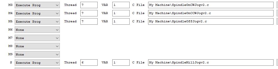

I used the "SpindleOnCWJogV2.c" and the other 3 files for CCW, Jog and Off and modified the CW and CCW bits and SPINDLEAXIS. See attached modified SpindleOnCWJogV2.c.

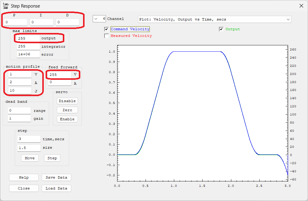

Change the Axis Configuration to have Velocity Feed Forward. This will cause the Axis Output to be proportional to the Jog Speed. Such as this:
Note: doing Move commands on the Step Response Screen should then cause the Spindle to move. Or Jogging the Axis from the Console Screen should set a Spindle speed.

Appears that I'm making baby steps. I changed the S back to Execute Prog to run the mill jog program. All 4 programs are set the Var 1. Is that correct? See attachment 1.

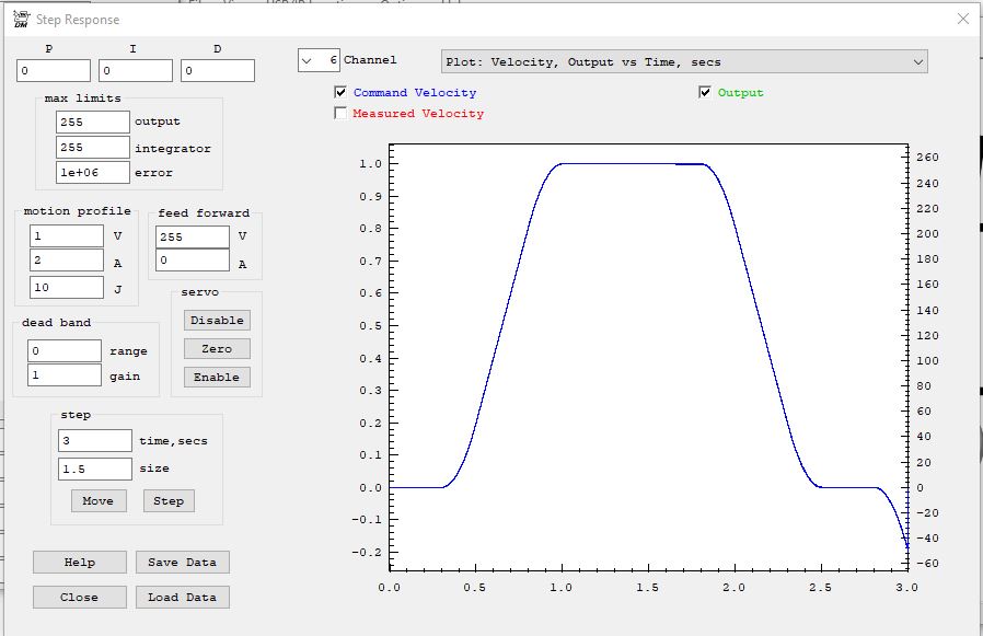

I changed the init program back to channel 6 and did the Step Response as shown in your example. See attachment 2.
AIso changed the 4 spindle jog programs to channel 6.

Because the Feedrate changes when the Spindle Axis is Jogged that would indicate that axis 6 is still included in the Coordinate System. The Init program you posted does not include it. Also the printf added to the function not printing would indicate somehow you are not running the program you think you are. As a sanity check you might add a printf("Hello\n); at the beginning to see if that prints.
