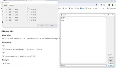

i was going to run the scope on the DAC's to see if there is noise running the spindle drive input
i try and set DAC1 to 0 and nothing happens
in fact i cant get any DAC to = a value
it connected and running. why would i not be able to input on the console?

Do you have an axis enabled driving DAC1?

when i spindle on, i get DAC output but i measure no volts on the actual DAC out pin :cry:

You didn’t show how your axes are configured. But if you have an axis writing to a DAC anything you write to it will be quickly overwritten. Disable the axis if you want to manually write values to it.

Gotcha
I'll try that tomorrow
Thanks for your continuous help!
