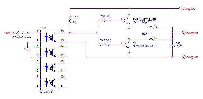

Here is an example using software, 2 Konnect Outputs, and a simple circuit to create an opto Isolated Analog signal. Response rate is not great but adequate for most applications.

i have built this circuit already, i am trying to find out how to configure an output as PWM from JP6, do i need a C program for that?
