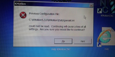

I'm finishing setting up the milling machine. I have completed the spindle operation programs in order to stop the axes and wait for acceleration / deceleration of the spindle. And I've already tested it through MDI. Everything worked fine.
Suddenly KmotionCNC froze, after which the PC started to reboot. After the reboot, the following messages appeared :
Windows 7 32
For some unknown reason, these files turned out to be empty. And KmotionCNC has reset all settings.
I have two questions:
1. Why could this happen?
2. How to save and restore KmotionCNC settings correctly? From where and which files should I save?
P.s. All my custom .c and .out files have not changed and are correct.
Windows 7 32

I'm not sure how the files got corrupted. If you answered Yes to the
"Continuing will cause a loss of all settings. Are you sure you would like to continue?"
then the parameters would be set to Default. But that doesn't explain how the files got lost/corrupted in the first place.
I suppose the mistake was to not back up the files.
