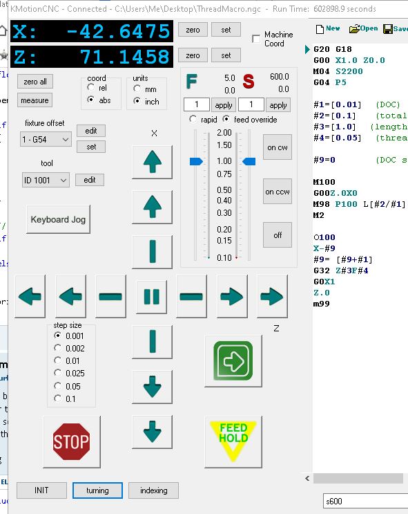

ok, i got the spindle servo mounted and ready to test run in jog mode. i just need the 5v and ground to the encoder
spindle encoder A/B to ch2
spindle Z to A4+ and A4- ( bits 8 and 9? )
i dont really under stand the SpindleOnJog examples as the 3 of them all seem to do something with ClearBit(154); ClearBit(155);
with using DAC output there is no need for any FET bit toggling right?

i had 2 buttons
one for turning and one for indexing
the old servo was a 3 phase AC though so it had some phase finding in the main init
now with the brushed DC none of that is needed

likely jumping the gun but wondering why i can "init" and have encoders read position zero and then when i push either turn or index button i get a new encoder position?
i mean neither index or turn have a set position type command in there right?

- Posts: 2935
Post
by TomKerekes » Tue Dec 12, 2023 1:08 am
No. Its only one bit going into KFLOP JP7 Bit 36
That depends on how your Spindles have an on/off input and +/- 10V to control speed and direction. Some have 2 inputs: on-forward and on-reverse to control direction and 0-10V to control speed
idk what is your Init Program doing? Post it. What are the Position values on the KMotion.exe Axis Screen?

ok,
spindle control
i have a 2000 count encoder with Z pulse
i use a +/- 10V to the drive
1-1 ratio pulley so there is no dirty little numbers there
no relays or on/off required
i want cw and ccw jog and also an A axis indexing

well after hours, again i am no closer to understanding where to put C codes or which to use in what configuration with VARS and thread numbers
sadly most of what i search on here just brings up MY previous threads on the same topic on here. lol
- Posts: 2935
Post
by TomKerekes » Tue Dec 12, 2023 11:01 pm
So we can help you please put more effort into your responses. Explain what you understand and don't understand, what you have done, and what happened.
I don't think you need any C Code at this point.
Did you do the 3 steps in the link? If so, what happened?
