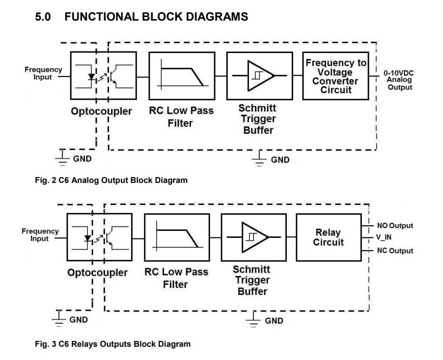

Related to noise - I currently have a 5/12V power supply connected to the Kstep. I have a separate 5V supply powering the Kflop (appropriate jumpers removed). The C6 requires a 12V supply. I'm thinking that I shouldn't use my 5/12V power supply to power the C6. The input side of the C6 has opto's but the analog output will have it's common connected to the VFD's common. It looks like there is a 12V/200mA source in the inverter. Do you agree that it would be better to use the VFD 12v source?
I agree. I think using KStep's 12V would defeat the isolation between KStep and the Inverter. KFLOP would still be isolated from the Inverter which is probably more important, but if you can keep the Inverter isolated from KStep as well why not?
