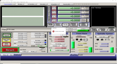

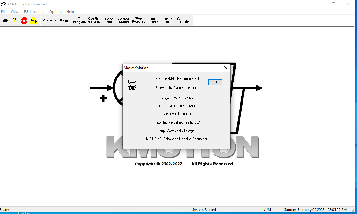

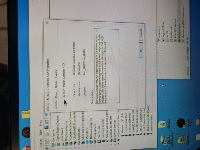

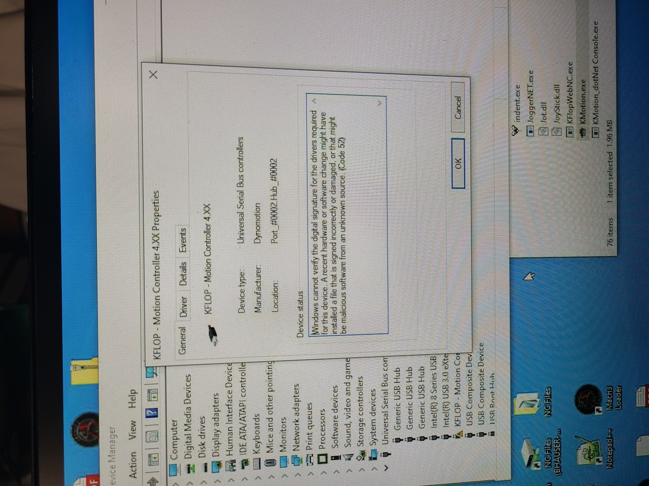

Post by bhauser » Mon Feb 06, 2023 4:26 am
I installed 4.35h, but it appears that windows is unhappy with the driver if it's not in test mode. I've attached some images of the issue when out of test mode. I can also confirm that it is not the keyboard causing this issue. I may try replacing my USB hub next.
