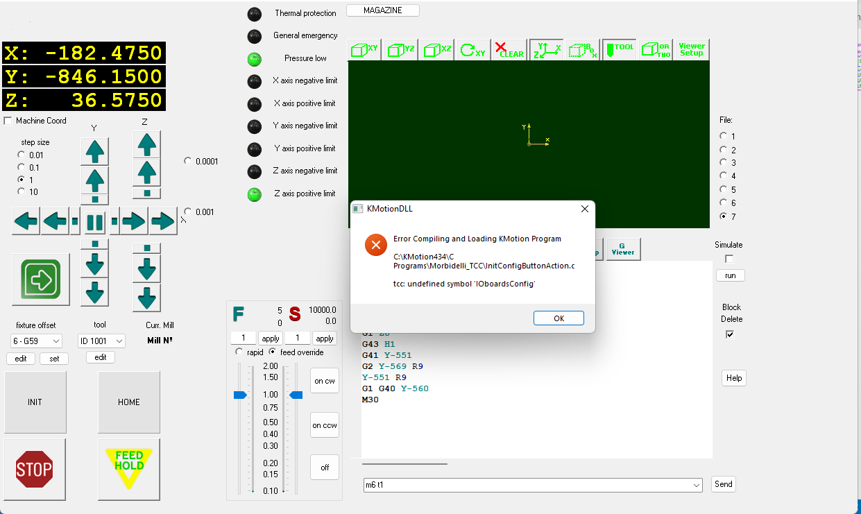

When I try to execute the Init button I get the following error:

Hi Guilherme,
The example in your reference compiles 2 files separately and then links the 2 files together.
KMotion is set up to simply compile one file and link it. So you must also include InitConfig.c in InitConfigButtonAction.c to form one .c file with everything.
There are ways to have multiple files linked together using the TI Compiler but it is somewhat complicated using batch files that you must create.
