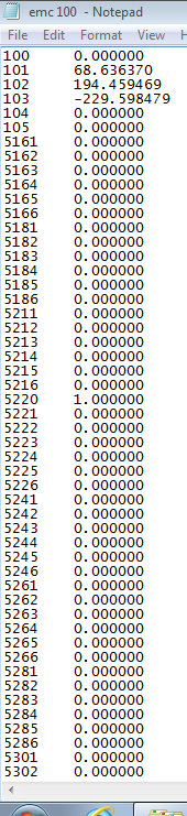

i had altered my program and modified my emc vars file so that i can store my dro value in #100, #101, #102 etc...
my doubt is that will this changes reflect in my fixture offset variable that is stored default in the emc vars file.

Variables #100 - #104 will have no effect on fixture offsets.

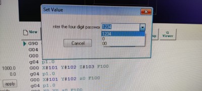

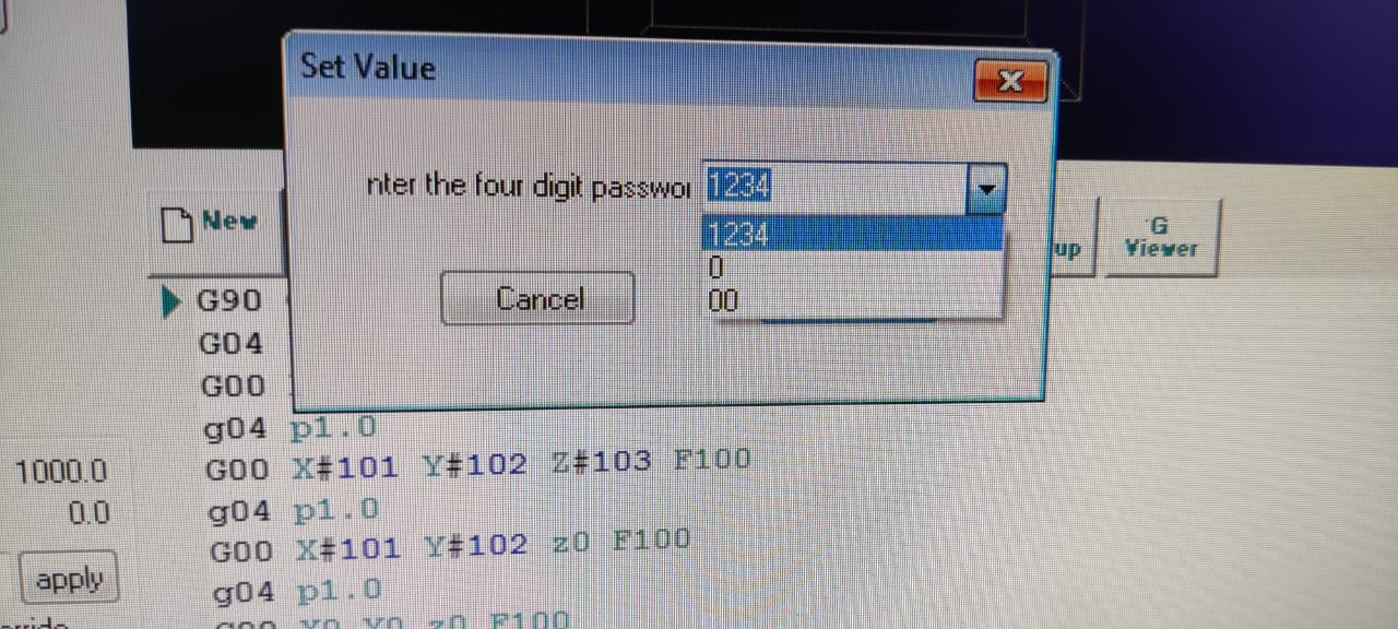

This is the program I have been used to change the gcode screen to read and writ mode along with the code to ask for a password.but there is a bug I wants to clear that is the password i have been using is stored and displayed as dropdown box whenever i entered the password.Is there a way to clear it
what happens if i use variables other than fixture offset variable?
Is there a limit that only a particular amount of variable can be stored and accessed in VARS FILE?
I wouldn't call that a bug. We already discussed this.
Like I said before variables 0-4999 are available for you to use however you wish. Nothing will happen unless you use them for some purpose.

my program to ask for password works fine but the password i have been typing in the inputbox get listed as dropdown box as shown in the above image. Is it possible to create to clear the drop down box.

My mistake I thought it was you asking the same question. See here.
But no there is no option to clear recent entries without changing KMotionCNC's source code.
