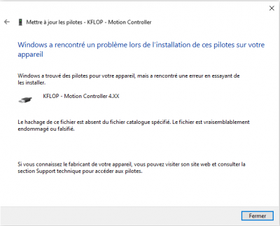

I have a problem with Kflop driver installation.
Windows 10 is saying "Windows Encountered a Problem Installing the Driver Software for your Device".
"The hash for the file is not present in the specified catalog file. The file is likely corrupt or the victim of tampering."
Do you have a solution?

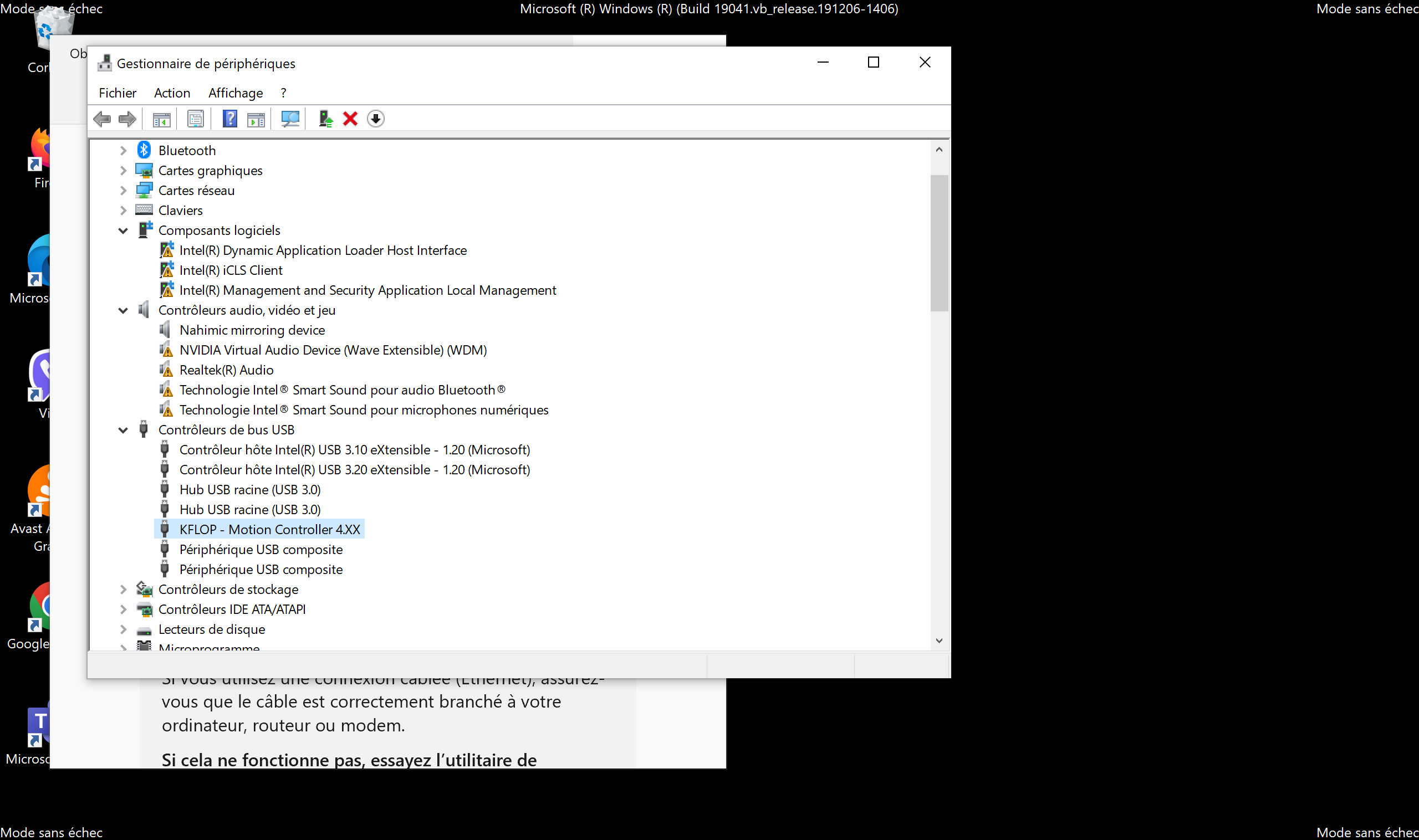

Update,
the probleme seems with signatures of drivers,
partially helped these advises
http://www.hackaapl.com/trouble-install ... r-signing/
I need to restart Windows in "Safe mode".
In this mode installation of driver was succesfull, BUT
when I start Windows normally still some problem with driver.
Please help.
Thank you.

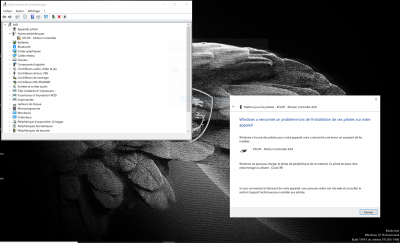

TomKerekes wrote: ↑Thu Jun 30, 2022 2:52 pmHi Evgeny,
Are you installing the drivers from Version 4.35f?
- Posts: 2953
Re: The file is likely corrupt or the victim of tampering
I don't know. You shouldn't need to run in Windows Test Mode. Did you try Uninstalling the device in Device Manager with the "Delete the driver Software" checked? Then Action | Scan for hardware changes. Then Right click "Update Driver" | Browse my Computer | C:\KMotion435f\USB Driver & include subfolders ?
Please show each step you are doing.
Maybe try on another computer.
Maybe some issue with the French Version?
Do you have all Windows Updates?
