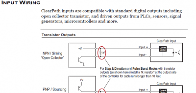

Hi Tom, setting up my kflop with kanalog board. Running 6 teknic motors on pulse and direction. First 4 motors are being driven by
kflop JP5 and the last two set to multplex on JP4 and JP6. FPGA(STEP_PULSE_LENGTH_ADD)=32 + 0x40; // set the pulse time to ~ 2us and multiplex to JP4 and JP6 . Just testing the motors on JP5 and set output to open collector mode to drive the 5 volt input on the teknic motors. I set the
OutputChan0=4 to run in open collector mode. This worked fine, can jog forward and reverse. When running at a jog setting of 1000 the motor runs
nice. When I run it bellow 100 I get a low frequency squeal and running it at 5, I get pulses in the rotation and not a slow smooth rotation of the motor.
When I run it on the teknic setup software I get a nice slow smooth rotation from the motor. Any suggestions?
George
Posts: 2546
Re: 5 axis CNC Router/3d printer
Post by TomKerekes » Tue Apr 05, 2022 2:53 am
Hi George,
You didn't specify the model number, any drive specifications, or any details on how it is wired.
A Google search found this. You might try adding a 1K pull up resistor as shown.
You might try using quadrature mode if supported by the Drive as it is much more forgiving timing wise.
Or increase the pulse length to max of 3.78us (63 instead of 32)
Or invert the pulse polarity (add 0x80)
But it is very strange that it would work at higher pulse rate and not lower. All these pulse rates are quite low.
Maybe a grounding issue?
