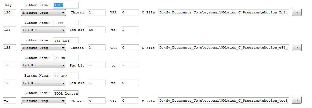

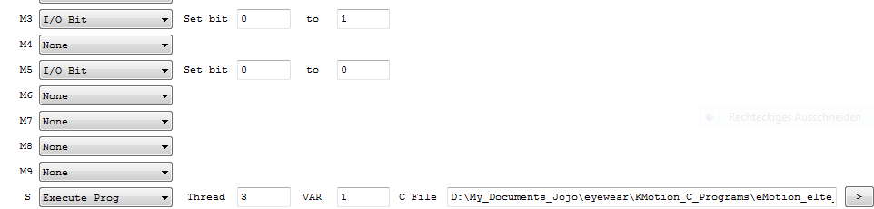

Re: how to implement a security switch launching a program / gcode
M3 and m5 are configured to set bit 0 to 0 or 1 (pic attached),which is really weird, since this bit is supposed to switch electric power on a second 220V-plug, that I currently dont use (and where nothing is attached to); it does not have anything to do with the frequency converter.. I guess this is still a left-over of my initial trials..
Can it be that M3 and M5 (F9 and F11) have a double effect, so not only whats defined in the tool-setup, but also the "regular" gcode-meaning of the M-command?
http://linuxcnc.org/docs/html/gcode/m-c ... e:m3-m4-m5
The second pic shows that I implemented two button to set bit 1 to 0 or 1, and thats the bit driving the electric power for the frequency converter. and this one actually works; frequ.conv. can be turned on and of with this.
finally had access to the machine yesterday and was able to timplement the door switch and the new init-script.
First of all, thanks for all the help, it worked out pretty well:-)
And yes, I was totally confused about the M3, M5 command... As shown in my screenshot, I actually did really use bit 0 (relay) to switch the spindle on and off in the frequency converter! Aside from the PWM that sets the rpm.. So, I dont hav to use
DoPCInt(PC_COMM_MCODE,5); // command M5
(which would also work), but
ClearBit(0);
to stop the spindle (equivalent to M5).
All this works pretty well now!

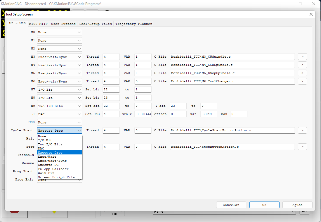

gui_marchioro
- Posts: 61
Hello Tom,
I have implemented a similar routine, to prevent Cycle Start to execute if the board was not properly initialized or homed. It does work, but the G code execute in average 3 lines before Halt. There is a way to prevent this to happen?
Below is the code that I execute when Cycle Start is requested:
Sincerely,
Guilherme
// Program to be executed when the Cycle Start button is pressed
// DoPC(PC_COMM_EXECUTE);
if (GetInitExecuted() == 0 || GetHomingExecuted() == 0 || GetIsExecutingHoming == 1)
DoPC(PC_COMM_HALT);
MsgBox("Execute the Init and Homing function before run a program", MB_ICONEXCLAMATION);
DoPC(PC_COMM_RESTART);
}Guilherme
- Posts: 2933
Do you have the Cycle Start Action configured to wait?
gui_marchioro
- Posts: 61
No, I was using just the "Execute Prog" (image attached).
Is it required to use "Exec/wait" instead?
Sincerely,
Guilherme
Sincerely,
Guilherme
- Posts: 2933
Yes
