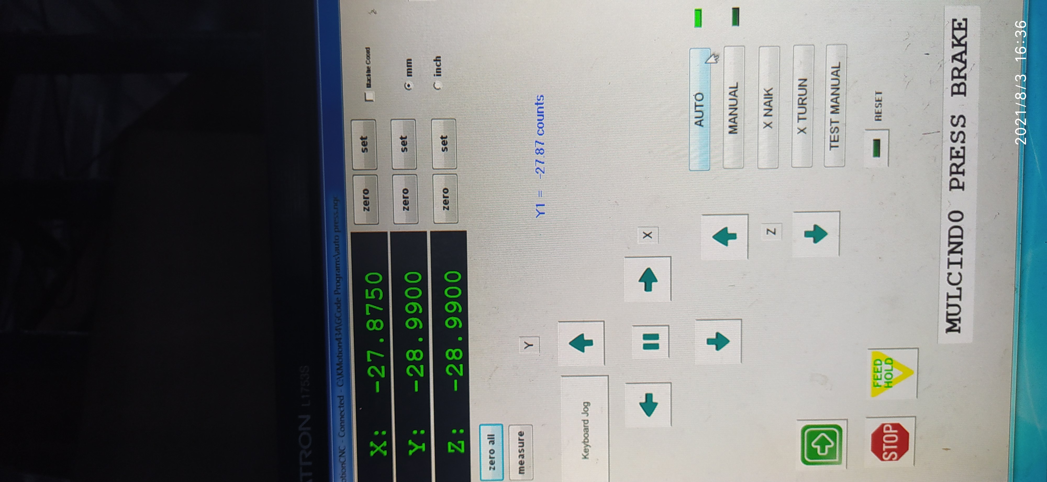

i love dynomotion, I can already display the Axis X indicator ( Y1 )
I am happy with you, always support me, every time there is difficulty.
thank you , sir.
