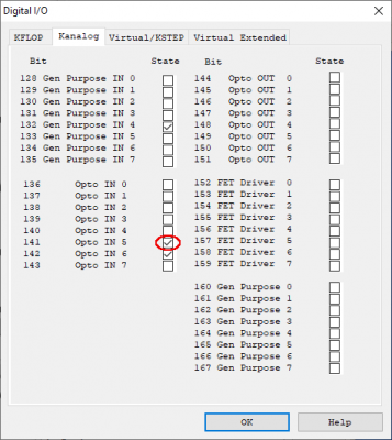

Are you sure you're monitoring the correct bit in the homing program?
I'm monitoring this Bit shown here. If this is not what I should be looking at, then I will need help to find the correct one please.
This one turns on and off when I operate the switch by hand.

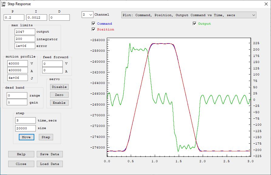

I have tuned my motors to the best of my current ability. Thanks for the direction to do that next. You were correct about the feeedback being reversed.
The first is the X axis, followed by the Z axis and then the Spindle.
As you can see, the Spindle has quite a sizeable Following Error (if that's the correct term) and I cannot reduce it significantly using the Integral term as I was able to do quite successfully with both X and Z. In fact it becomes unstable before it has had any significant effect at all. X & Z behaved themselves pretty much like 'text book' cases.
Since it is the Spindle, perhaps it won't matter so much, although I would like to be able to do single point thread cutting with it. Maybe I can play around with the motor drives later and see what I can find there, but for now it will do. On with continuing to get my head around the C programming stuff tomorrow!
