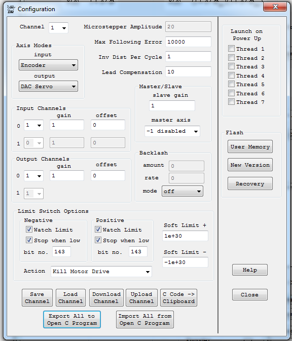

One issue I see is your tuning is mostly relying on Velocity Feed Forward to create the 1200 DAC counts of output. The Integrator gain is low and the limit of 100 DAC counts prevents it from doing much. Feed forward is like driving blind folded. If the road is perfect and you anticipate corners perfectly then you can stay on the road. But if conditions change, or there are external disturbances to push you off the road, you won't do very well (cutting forces).

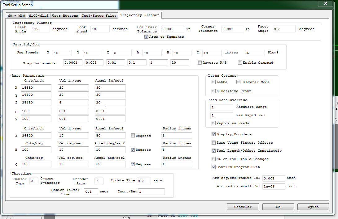

On the other hand, the Max Following error is set at 100 encoder counts. This means the servo errors never exceed 100 encoder counts. Which is:
100/15880 = 0.0063 inches = 0.16mm
Which is about the thickness of a piece of paper. Your errors seem larger than this. So that would indicate something mechanical such as lead screw backlash or other mechanical compliance or resonance.
The Step Response Plots only show errors of ~15 encoder counts. You might reduce the Max Following error to find the lowest value where you can still run GCode and cut wood without faulting.

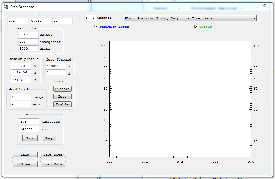

Below a photo with the tips that you posted above about I and D. (It works great, no plot because machine is off, soon will post plot)

I tuned the Y servo, but if i use more than D10 it gives some unstability at a speed of ~5m/min
no unstability in the plot screen.
attached are the info.
Thanks Tom.

Its not clear what you are asking.
You didn't include your Step Response Screen settings.
Have you tried tuning? What have you tried?
