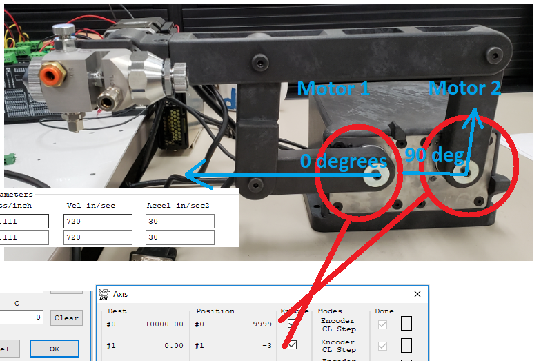

Hi Scott,
I think your Homing routine has the motors swapped. Motor1 (Axis 0) should be at 0 degrees. Motor2 (Axis 1) should be 90 degrees. So try changing the Home Program to result in that. Having the opposite probably results in an impossible pose.
Normally +X is to the right and +Y up. Your convention for X is backwards.
Also defining the XY origin to be at Motor 1 is not very logical. For the algorithm to solve for the XY position it needs some reasonable starting guess. It uses 0,0 as an initial guess. In your convention this would be at an impossible orientation. So I added an adjustment to have the XY origin be at the payload home position with:
	// adjust xy to be zero at neutral home position
	x = -x + L1 - S;
	y += R3;
I also added code to define Actuators 2-5 so the variables wouldn't be undefined
	Acts[2] = z*m_MotionParams.CountsPerInchZ;
	Acts[3] = a*m_MotionParams.CountsPerInchA;
	Acts[4] = b*m_MotionParams.CountsPerInchB;
	Acts[5] = c*m_MotionParams.CountsPerInchC;

TeachMotion example was modified to read motor angles from KFLOP and simulate the linkages linkages
