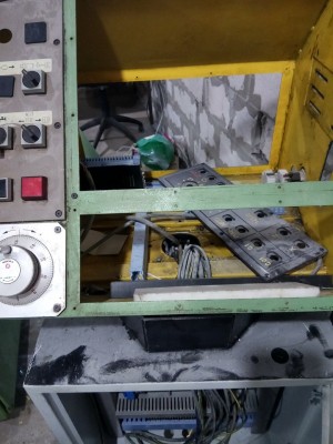

Modernization of the lathe machine Schaublin 102 cnc

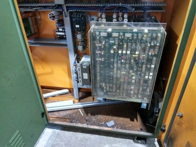

After cleaning
Schaublin 102 cnc
- Posts: 5
