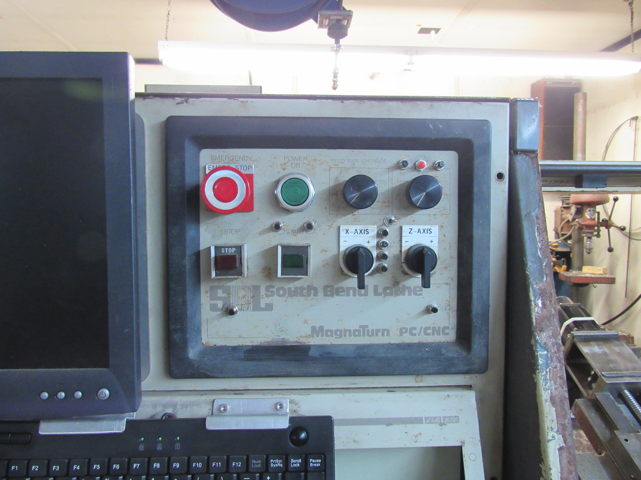

What iam working on is a custom USB keyboard to control certain areas of machine without the use of C code.
I almost have my Jog lever switches working but because the step jog move requires a Crtl key to be held, iam having issues. I need to be able to change the mode of my lever/switches from continuous to step. Was going to have a toggle switch act as a Ctrl button but this causes an issue with other keystrokes if user leaves this toggle switch on. Only other option i can come up with is a momentary button that has to be held in, which makes it a little cumbersome to use jog levers.
Attached is pictures of my sort of crude control panel so far.

Personally, I'd wire Jog buttons directly to the KFlop, as it'll make them more responsive and give you more options of exactly what they do.
However, I'd also say get an MPG. I rely on the keyboard on my lathe, and although it works, it's no where near as nice as using the MPG I installed on my mill (pic attached). My next iteration of a control panel will likely do away with the axis/step selection switches though, with that functionality moved to buttons in a custom screen set (wiring up the switches was a PITA, and I need to use the screen to enable the MPG anyway, so selecting axis/step size on the screen will be just as easy).

I can't think of a means of "scrolling" through the step sizes. But you could select any of the sizes. It looks like your panel has 4 push buttons for the sizes? That should be implemented easier than the scrolling and have the advantage that the Operator wouldn't have to look at the screen to see what to do. If you do need the scrolling we could add a KMotionCNC command to read the current step size selection.
