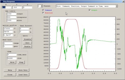

Re: DMM-TECH Analog Tunning
Ok, now that i have the Z axis mount reworked and filters on drives, as i mentioned on the CNCzone post, iam ready to try Analog mode again.
Attached is just a base movement so far on X axis under Analog Closed Loop.
This is a test move of 1.0" (20320 counts). I didnt move further as i was worried about runaway. Because the movement is unstable.
When axis is not moving i can manually turn ballscrew and move table about .01" before servo will start to hold. On the Axis screen of Kmotion the Position shows about 70 to 80 when i turn ballscrew by hand.
What is your recommendation on what i should adjust next.
Troy
Hi Troy,
It doesn't look like the axis is unstable. I suspect the motion profile is excessively aggressive which is completely different from servo instability. Bigger moves involve higher speeds and accelerations which are probably not possible. Its like me thinking my car is capable of 1000MPH but so far have only tested it in the parking lot.
The Velocity setting is 300000/20320 = 14.8ips = 886ipm ??
The test move is only running at about half that. See below:
Acceleration (148 in/sec^2 = 0.4G) and Jerk (1480 in/sec^3) are very high.
You might read this.
Afterward you should be at the point of adding D Gain in the process described here
The Velocity setting is what i was able to achieve in CL Step/Direction mode. It was very fast. But in Analog it wants to runaway real easy. Thats why i only did a 1" (20320) move.
m_murray gave me his settings from his 4th axis(Analog mode), just got done trying them and info in your link and i got decent results. But Velocity and Jerk is not as fast and output plot is not as smooth.That said iam still getting about 797ipm, if i figured it right.
Why would the Step/Dir be faster and output look smoother?
He got the IR filters and settings from his other axis that a previous owner used for tunning. Dont know why, but it worked for him and seems to be working for me. Can you make sense of it? Maybe there is something in the filters i need to change for my setup?
Attached is files and screen shots.
Thanks again,
Troy
Thanks again,
Troy
- V2XaxisAnalogDrive1000.zip
- (377.72 KiB) Downloaded 184 times
Once you've got a rough tune, where commanded and actual position are roughly inline, I'd switch to the following error and output display, as it gives a more detailed overview of what's going on.
The key thing that stands out on that, is you're maxing out the output during the initial jerk limited acceleration. You probably want to reduce the jerk setting so the output isn't maxing out.
I personally wouldn't worry too much about the output being a bit spikey, provide the system is stable, and following error is good. I suspect most digital drives will have a certain amount of filtering on the analogue inputs, even in torque mode (I know the drives I use do), so the spikes will be filtered to a certain extent anyway.
Hi Troy,
Thats great that the pole zero filter is working for you too! No idea why they are not used more often by others, they work great on my machine on all axes.
Feel free to tweak velocity/accell/jerk as you want. You can also play with P and I values, but I think you most likely wont need D gain with pole zero filters. You should be able to get the same performance as you were getting with step/dir. Keep in mind this is just a lathe, and only medium sized one. So crazy speeds are not a really big deal. Your normally cutting way less then 50 IPM on a lathe and rapids are short. Id be happy enough with 3-400 ipm on a lathe unless your doing huge production runs.
I dont think id worry about output not being smooth.
I eneded up reducing Jerk to 1.1+7 to remove small Output clip.
Something iam trying to do now is tighten up servo when it is not moving. I can still easily rotate ballscrew and show about 5 counts in the Axis Position window. When in Step/Dir i could not move it at all. What settings affect this?
I also did a quick test on Z axis by duplicating all settings of X axis to my Z axis(Channel2). Something i noticed is on the Configuration window the Microstepper Amplitude is grayed out and set to 20. On my X axis(Channel0) it is 250 and grayed out. Why is this different?
Troy
Troy
Hi Troy,
That is probably good, but you might have increased the Max Output and Max Integrator Instead.I eneded up reducing Jerk to 1.1+7 to remove small Output clip.
If you hold off the axis by 5 counts the output should ramp up to the your max Integrator value of 800 DAC counts to try to eliminate the error. You might check on the Analog Screen that the DAC is commanded to + or - 800 counts. Or check with a voltmeter that ~4V is being commanded to the Drive. If you increase the Max Output and Max Integrator to 2047 then the full 10V should be commanded to the drive.Something iam trying to do now is tighten up servo when it is not moving. I can still easily rotate ballscrew and show about 5 counts in the Axis Position window. When in Step/Dir i could not move it at all. What settings affect this?
In your Output Mode all the grayed out parameters are not used and do not matter what they are set to. The displayed value is whatever was the last value set to that parameter.Something i noticed is on the Configuration window the Microstepper Amplitude is grayed out and set to 20. On my X axis(Channel0) it is 250 and grayed out. Why is this different?
