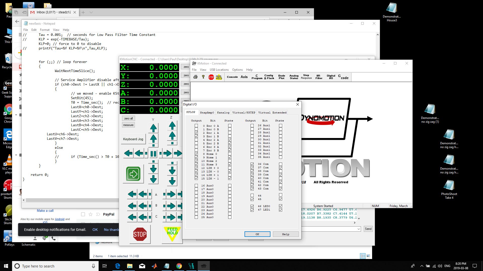

I used :
FPGAW(ENC_NOISE_FILTER_ADD) = ENC_0_3_JP4 + ENC_4_7_JP6 + ENC_NOISE_FILTER_DEFAULT_VAL;
in my C program, however, the encoders are not working. The board disconnects from the computer as soon as it runs a few lines of G-code (It works perfectly fine without the encoder connections and a different config setup). Also, the step response plot for the measured velocity is 0. I am using the same JP4 and JP6 pins and I/Os as we discussed earlier.
I am uploading my code here (new8axis.txt)
Is it because I am using the wrong configuration?
My steppers have 5VDC differential encoders. I am supplying the 5V from an external source. And I am operating my KFLOP with USB power. I am also uploading a screenshot of the digital I/O screen.
Thank you again
I used :
Thank you again

Re: Question on encoders and limit switches
Hi Sagar,
It seems you configured IO bit numbers for the Input Channels rather than the Encoder Channel number to use.
For example KFLOP Axis Channel #0 should specify InputChan0=0 to use Encoder Channel #0.
You might read this article.
It isn't clear why this would cause a disconnect, but please correct this and see if there are still any problems.
