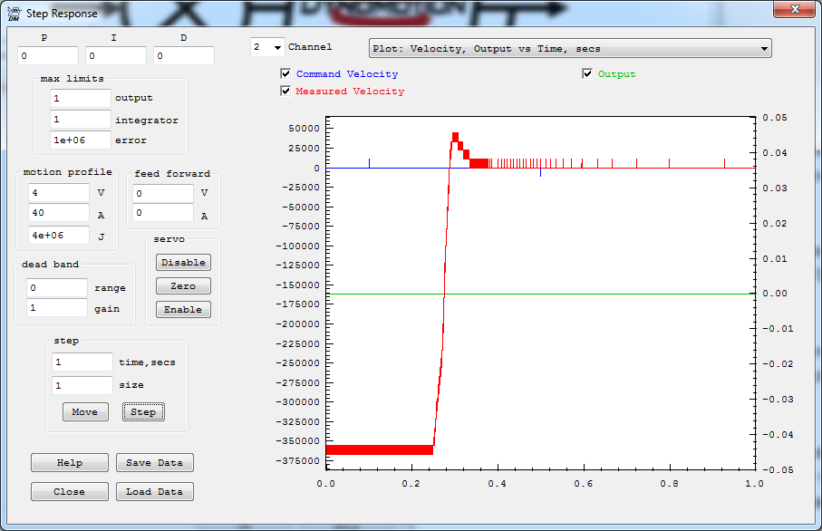

Here's a screenshot of the step response for my z axis. No matter what I enter it shoots up like crazy until it hits the limit.
Posts: 2952
Re: Are threads stopped during step response tests?
Post by TomKerekes » Fri Jan 06, 2023 9:18 pm
Hi Roamin,
Are all threads stopped when trying the step response tool?
No
It rarely makes sense to use the Step Button (trajectory with infinite velocity) so please only use the Move button.
Plotting Position rather than Velocity usually is easier to understand. Actually if you post the raw data we can plot it however we wish.
Pushing the Move (or Step) button causes the axis to be disabled, downloads all parameters from the Step Response, Config, and IIR Filter screens to KFLOP. You didn't post those screens. Do all these parameters match whatever parameters are in use when it works with GCode and such?
The disable/enable should only take a few milliseconds but the plot starts off with a Velocity of -350000 encoder counts/second. This seems very strange if the axis wasn't moving before the button was pushed.

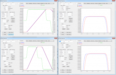

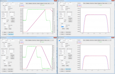

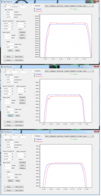

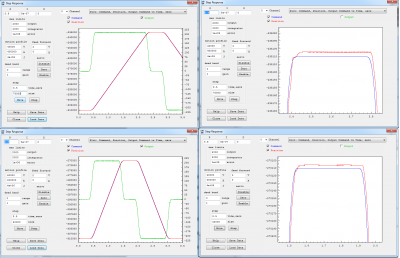

I'm happy to say that once I imported my config back into the settings screens, the machine no longer freaks out when I try to move ;). I've been slowly changing parameters based on the following logic :
Set P high enough so that the axis oscillates.
Lower P until it stops oscillating
Set I high enough so that it oscillates.
Lower I until it stops oscillating
Set D high enough so that it oscillates
Lower D until it stops oscillating
I'm getting decent results , but I am unsure if I'm supposed to try and clean the graph even more than what's on my screenshot.
Posts: 2952
Post by TomKerekes » Mon Jan 09, 2023 6:18 pm

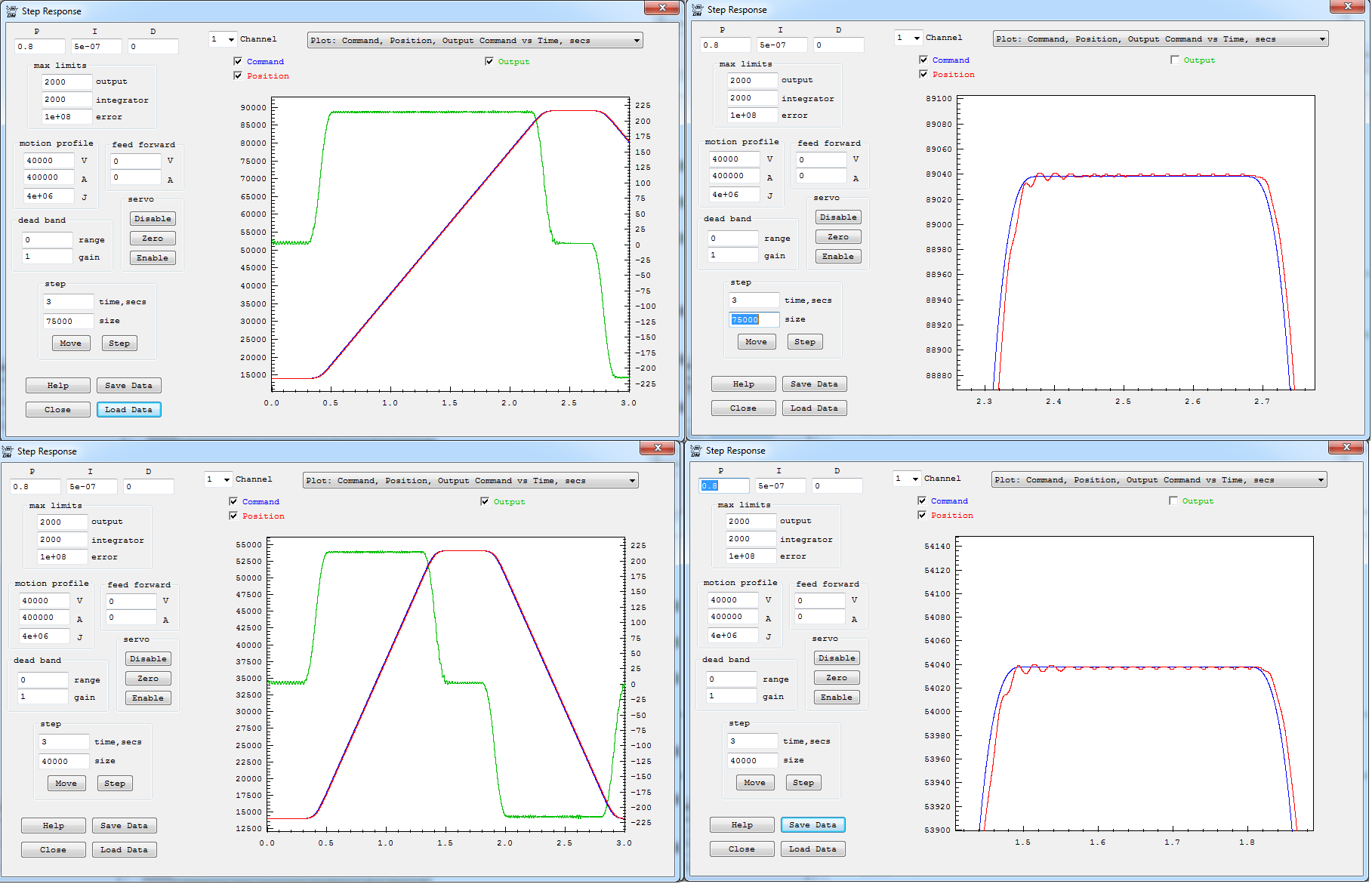

Hi Roamin,
Great!
Correct. Note the plots show P=0.805. It typically takes +/-10% change in a parameter to make a noticeable change. And if a tiny change does make a difference it probably won't be consistent over time position etc. So I'd use a round number like P=0.8
I would normally tune D next instead of I. It doesn't look like you did this as I is zero or near zero.
It is helpful to plot Output. Again if you would post the raw data we could do this. This would show what is being commanded to the Drive which would show us if the command is causing velocity or acceleration. I'm guessing the Drives are of Velocity Type as they have a Tach input? But it's hard to say how well that works being simulated. You might post your Tach Program.
Again the plots all show 0 so it doesn't seem you did this. Its not clear if D is needed as this is supposedly supplied by the Tach Program and analog feedback. But there still may be some usefulness. When D Gain is used it is useful to add a low pass filter to add smoothing to the spikes caused by the integer steps in the encoder reading. Typically 2nd Order Low Pass Freq=500 Q=1.4.
D gain adds damping and makes the system more stable (up to a point where the implementation of the Damping itself goes unstable). I like to think of this like submersing the system in honey. It moves slower and oscillates less which should allow other gains to be higher. So after optimizing D the P gain should then be re-tuned.
It looks like the plots are tracking within a few counts. Plotting Error is more useful at this point.
What is the resolution of the system in counts/inch? That would tell us what these errors are physically. What are your expectations in terms of precision, velocity, acceleration?
Note the Move of 5000 counts is not long enough to reach full velocity of 40000 counts/sec.

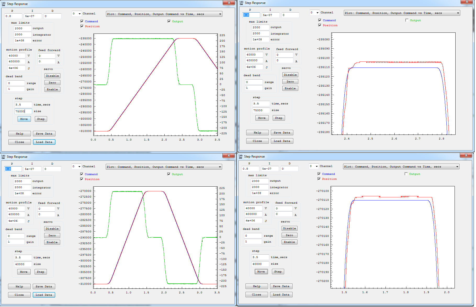

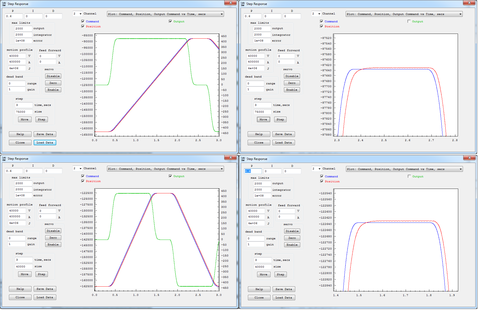

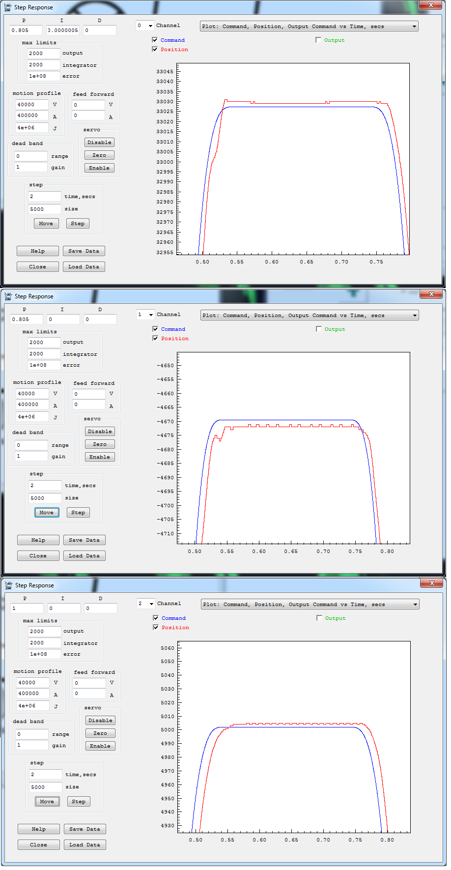

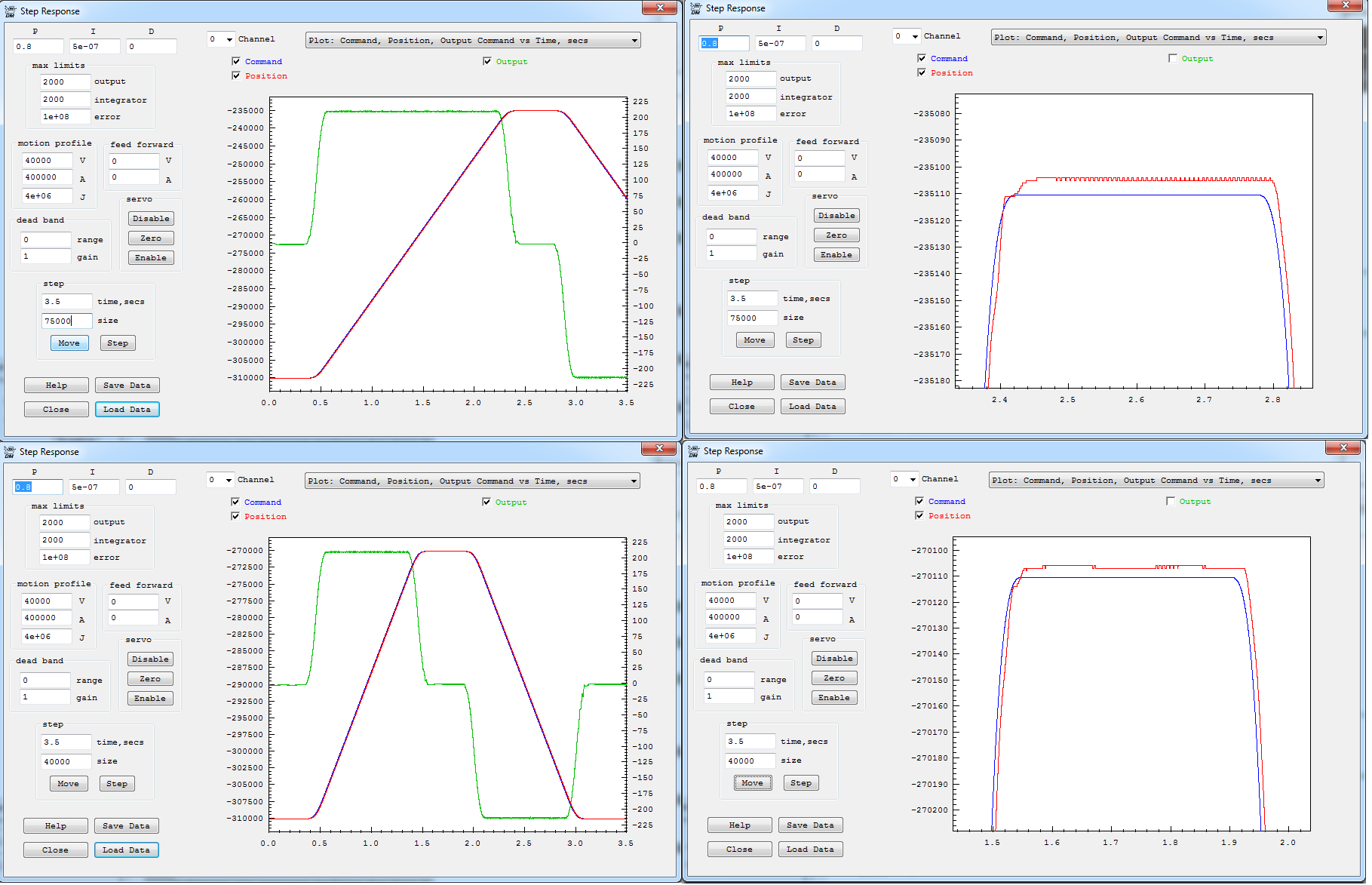

I have gathered all (i think) the information you asked for. I included the raw data for all 3 axes , the code that generates the tach (it constantly loops in thread 1 after setting up the axes. Within that loop I also check a few bits to make sure all switches are in the correct state.)
I believe the machine (Fanuc 5m) originally has the following capabilities : 400 IPM , 0.0001 inch precision, unsure about acceleration?
The drives are indeed of Velocity type, with the dac sending voltage straight to the Velocity Control Unit VCMD wire.
The tach is generated based on position and time, with the dac connected to the TSA wire.
I got the data from a 40k steps move and a 75k steps move in all axes.
You might noticed some comments in the tach code are in french , as I am French Canadian , we tend to mix both languages as we do things.. Although perfectly fluent in English , sometimes my comprehension of more technical things (especially things I'm not familiar with) takes some time..
If there's anything more you need, let me know. If you have documentation I should read to grasp all the tuning concept better, I'd definitely look into it.
I am unsure how you plan to plot errors ? By looking at the graph or the raw data?
Your help is greatly appreciated, as always!

Posts: 2952
Post by TomKerekes » Wed Jan 11, 2023 12:12 am
Hi Roamin,
I don't see any raw data files attached. You might need to Zip it if too big.
It doesn't seem you addressed many of the points I made in my last post. So I'm not sure what to do.
Errors are probably around 300 counts. 300/33898 = 0.009inch. Not very good.
I'd prefer to work on only one axis. Once it is tuned you can do the others an a similar manner.
The code doesn't have a main function. I assume you aren't showing it? Is there any delay in the loop? as shown it is looping as fast as it can. If looping too fast (small dt) its output may be very erratic because of encoder quantization errors (sometimes you might measure a change of 1 and sometimes 2).

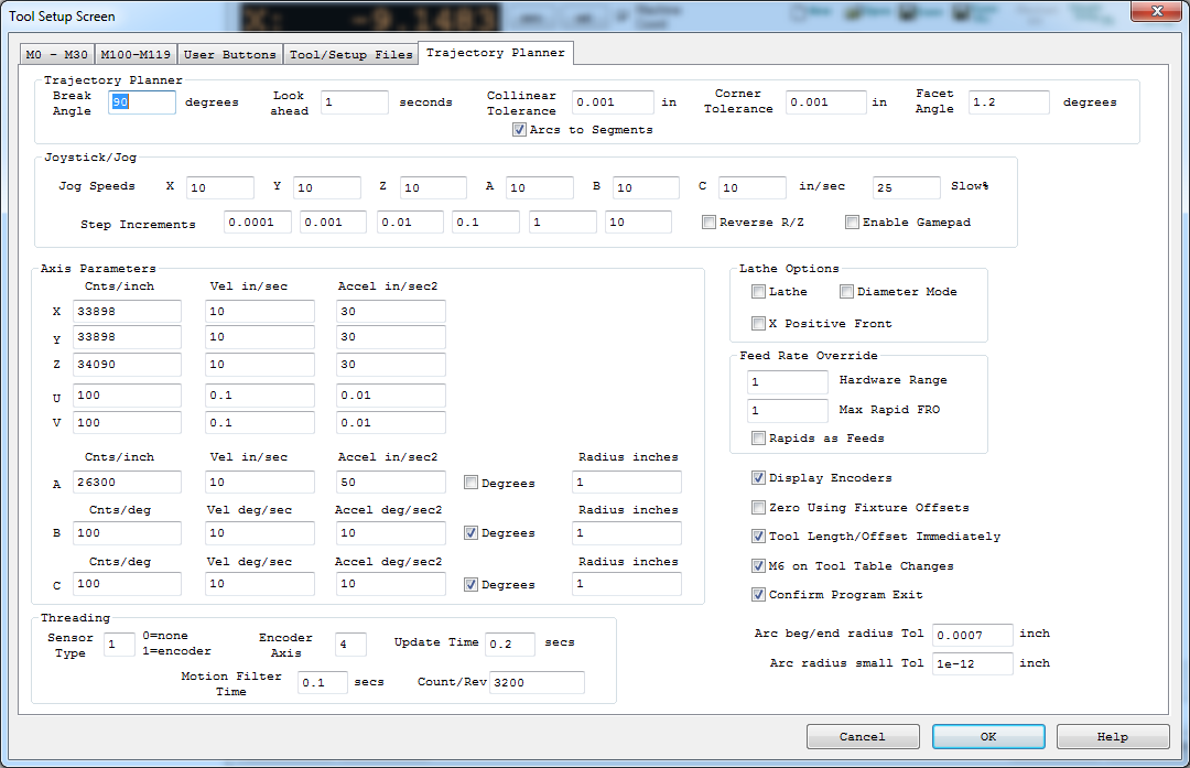

I believe the machine (Fanuc 5m) originally has the following capabilities : 400IPM , 0.0001 inch precision, unsure about acceleration?
You have KMotionCNC set to 10ips (600IPM). With 33898 counts/inch and V=40000 that is 1.18ips (70.8ipm). Testing slow is ok while tuning but you will eventually want to test at max velocity you will be using. I see only about 200 counts of Output is being used which is about 10%. So you should be able go about 10X that velocity before saturating the velocity command at 10V.
One of the Plot types is "Position Error, Output vs Time"
It occurred to me you could perform the Tach Function with 3 dummy Axes with only D Gain. This would then sample faster (every 90us), more consistently, and would allow a Low Pass filer to be used to smooth noise in the output caused by encoder quantization. See the diagram below with everything zero except D (and IIR Filter #2)
